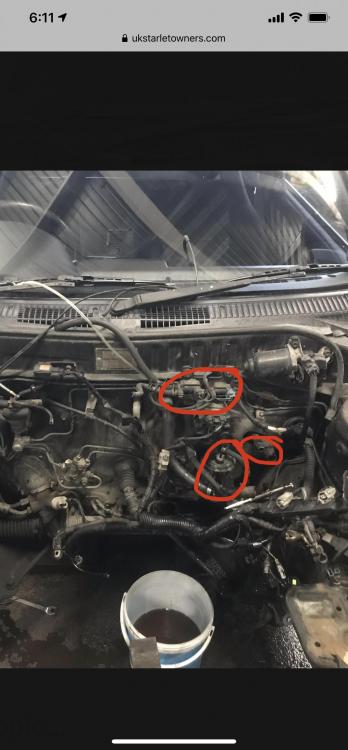

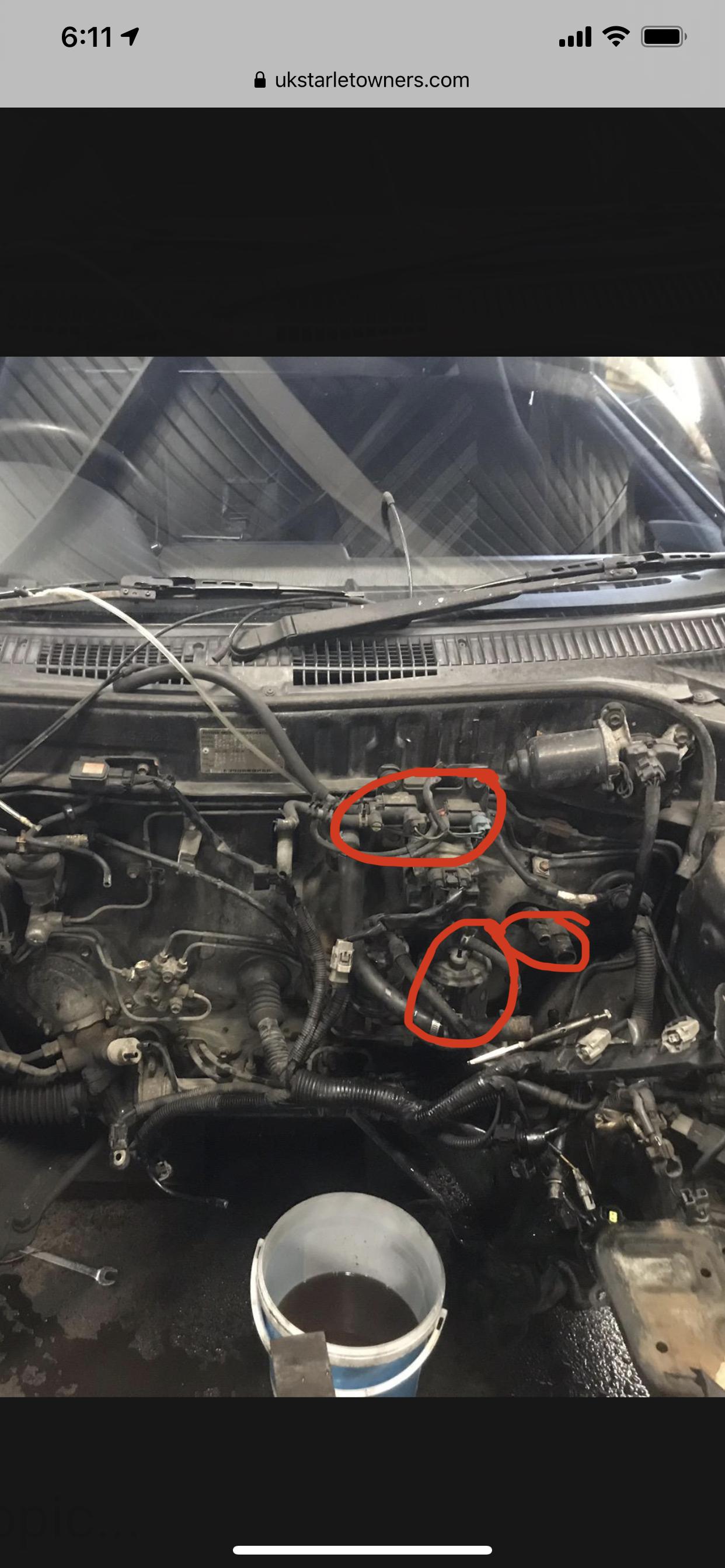

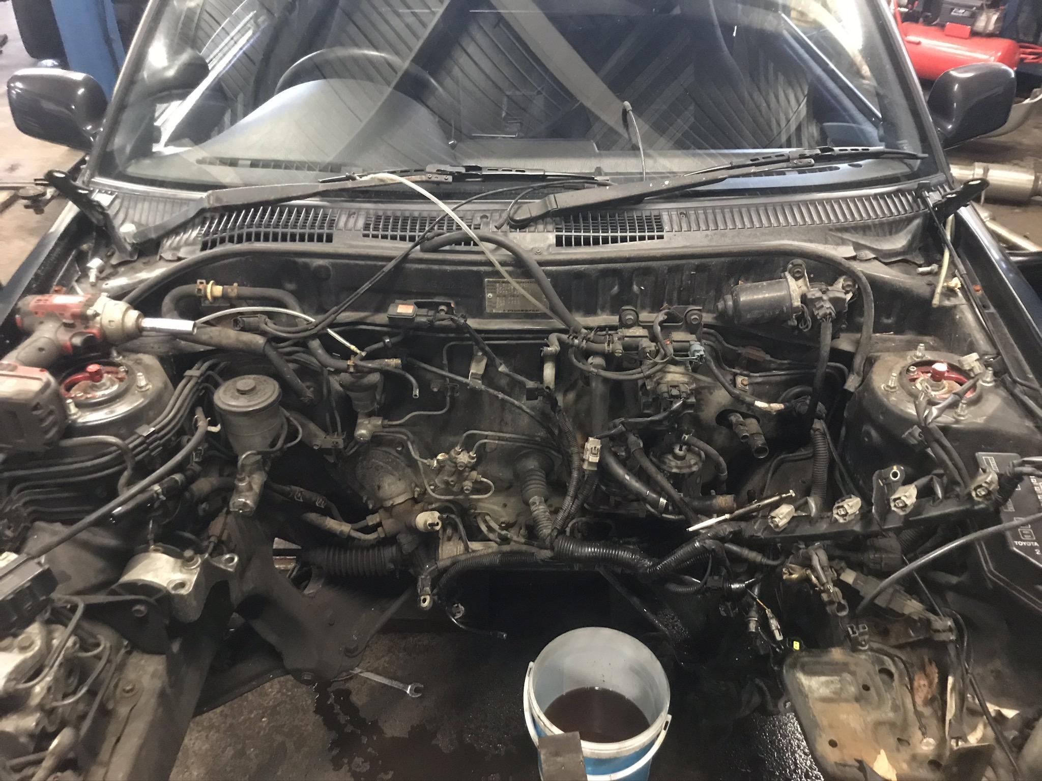

BurtEP82 Posted December 21, 2019 Posted December 21, 2019 So, engine is out for a standard rebuild/bay freshen up. I’m aware the the evap can be binned. Question for those that have been here, what else can be deleted to lessen the load on the appearance? I’m only going for speed vision ct9, wepr external gate. All inputs appreciated Thanks, Tom Quote
T-dog Posted December 21, 2019 Posted December 21, 2019 If you have removed the aircon , you can remove all of this stuff and just bung off the few pipes of the throttle body and then remove the charcoal canister and just vent the pipe to the floor . Toby 👍🏼 Quote
T-dog Posted December 21, 2019 Posted December 21, 2019 And also get a non aircon grommet for the firewall and remove the evaporator from inside the heater box Quote
