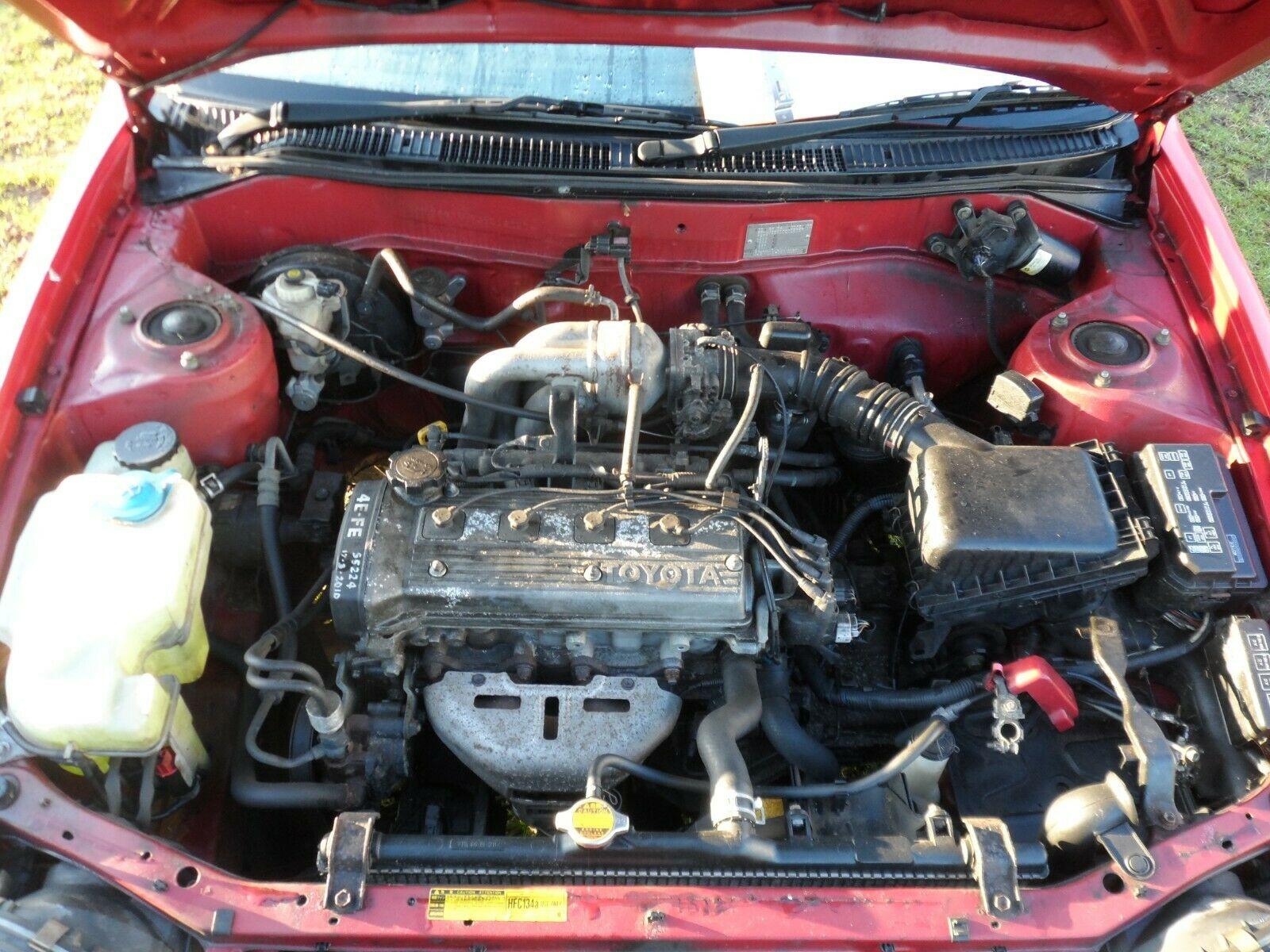

Grayedout Posted January 28, 2020 Share Posted January 28, 2020 Is this the Corolla 4EFE inlet manifold that can be fitted to the Starlet for a power increase? Would I need the throttle body as well? Quote Link to post Share on other sites
SKINY Posted January 28, 2020 Share Posted January 28, 2020 Yuup, I fitted them to my rep and it dynoed at 86.6 hp 😎 Quote Link to post Share on other sites
Grayedout Posted January 28, 2020 Author Share Posted January 28, 2020 What about the brace bar between the inlet and the head? Quote Link to post Share on other sites
Pinkygti Posted January 29, 2020 Share Posted January 29, 2020 I used the corolla brace in the end I think, from memory they are the same though Quote Link to post Share on other sites
