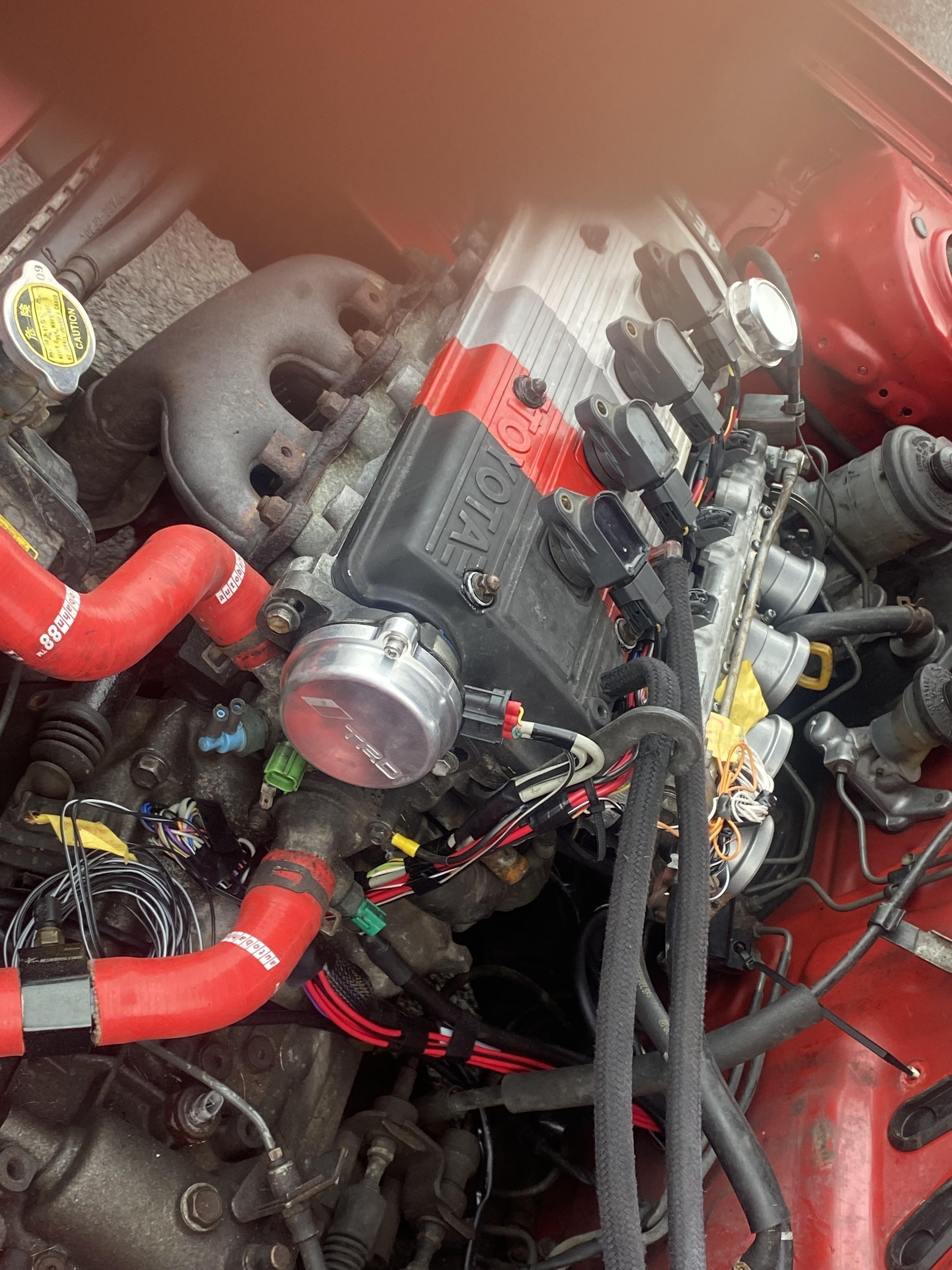

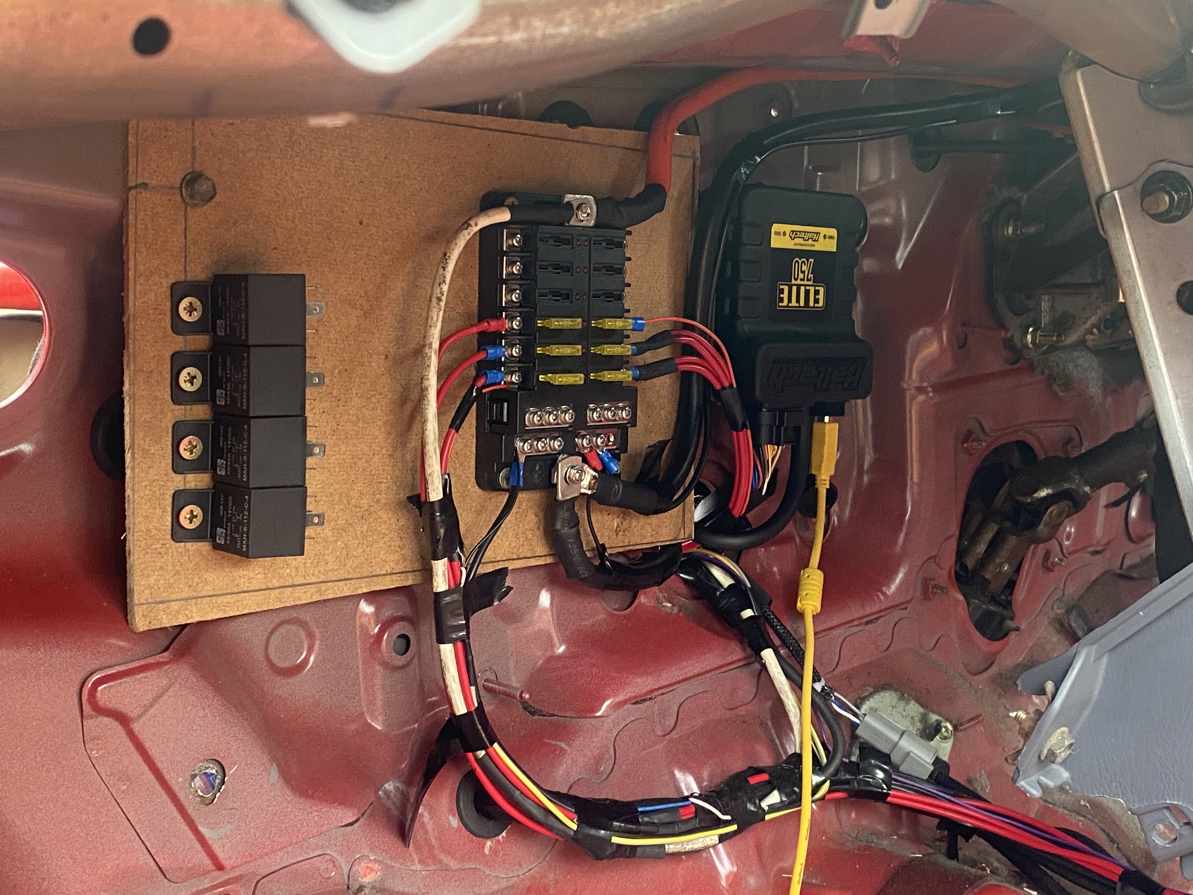

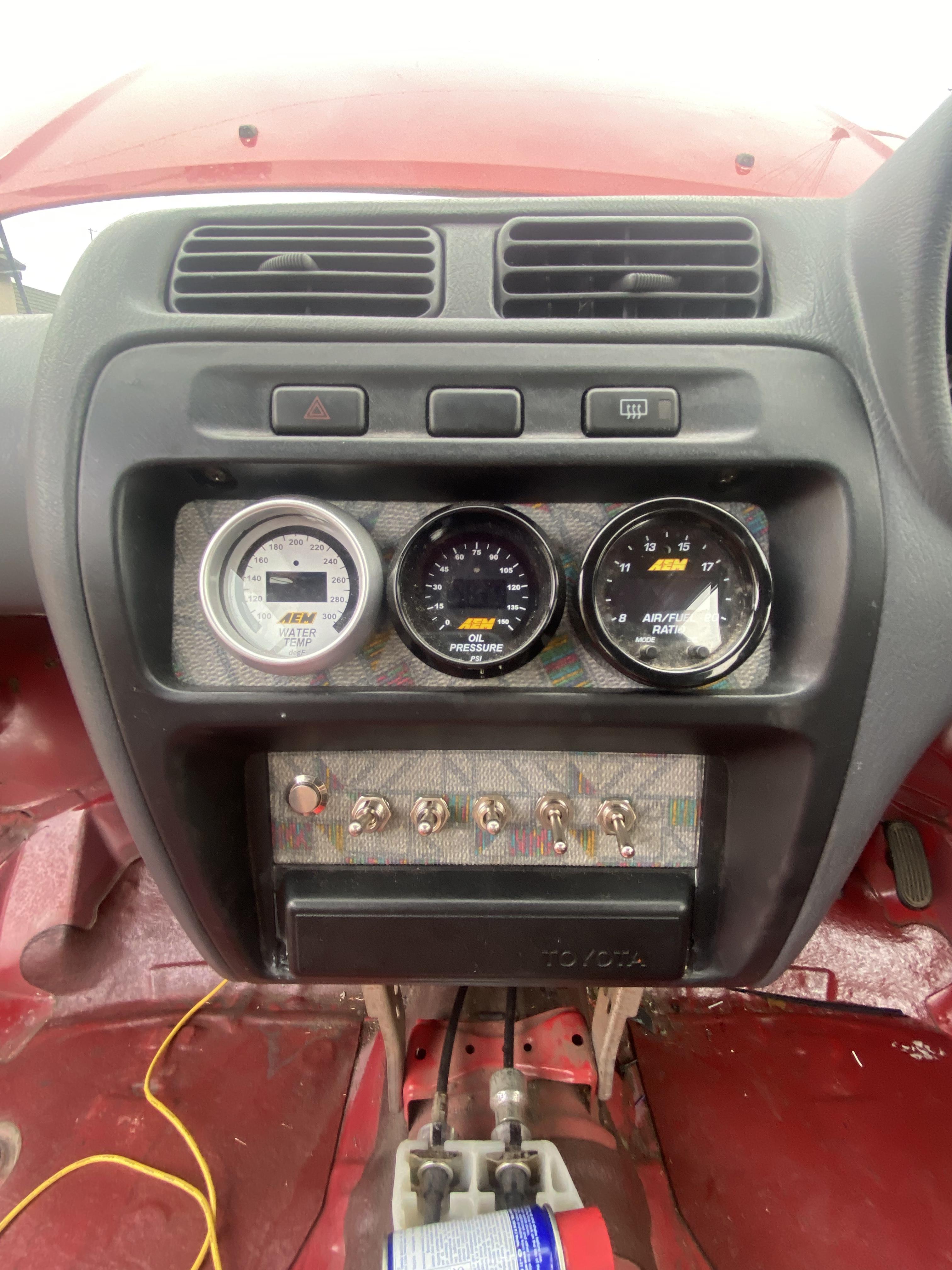

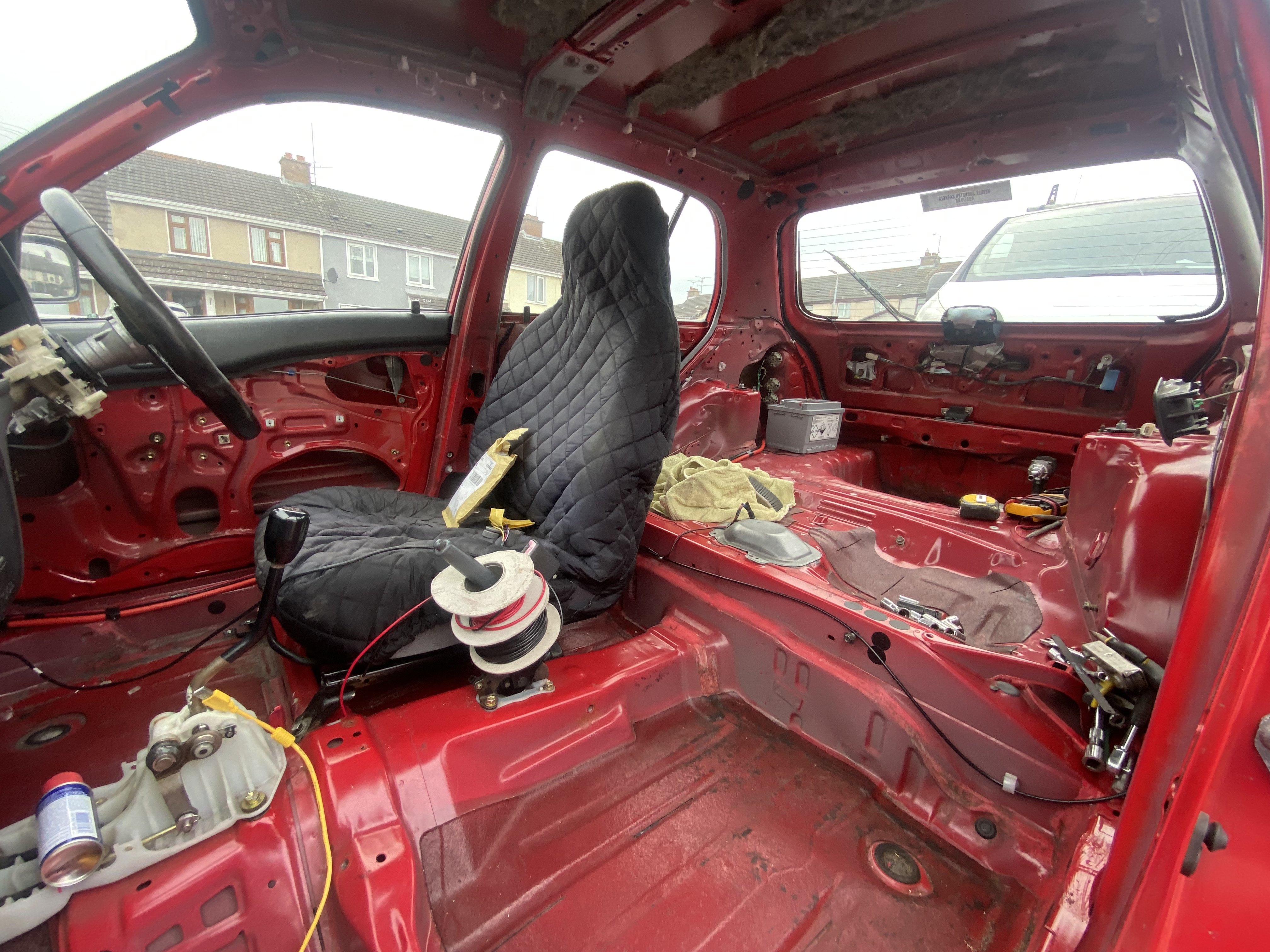

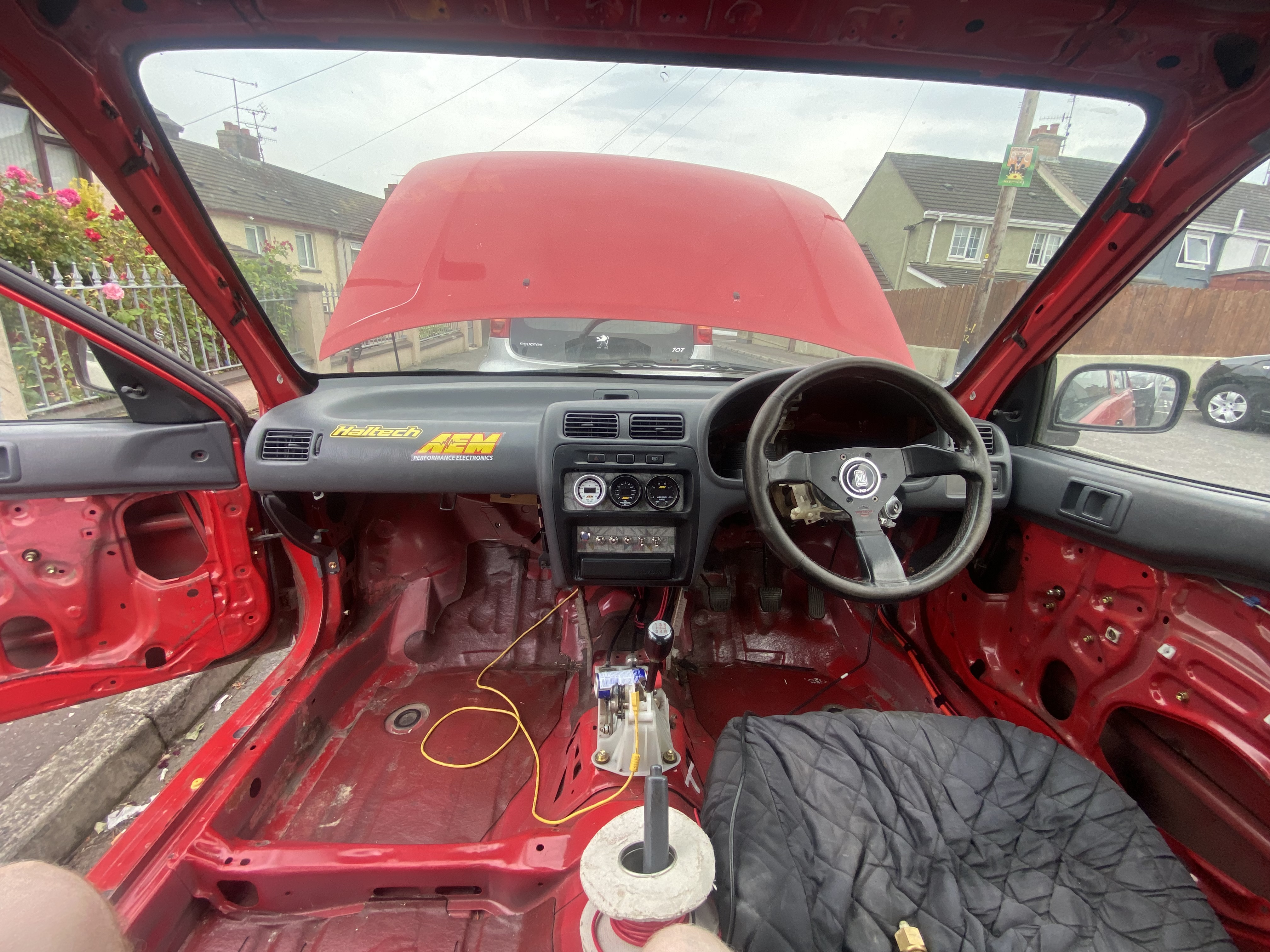

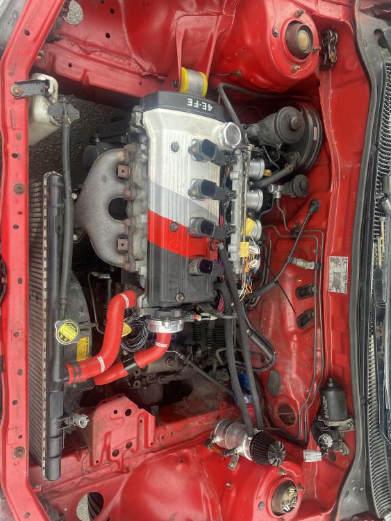

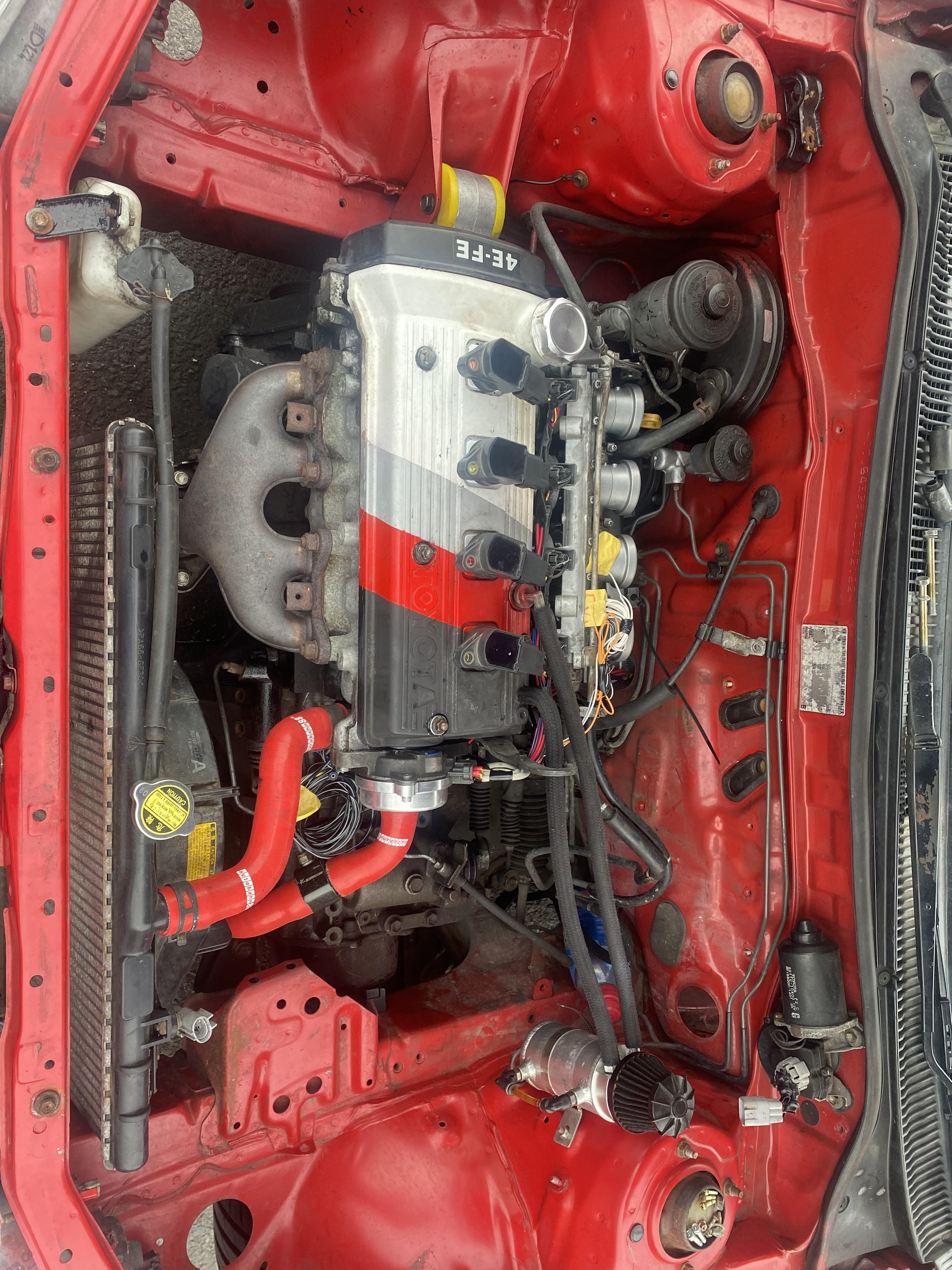

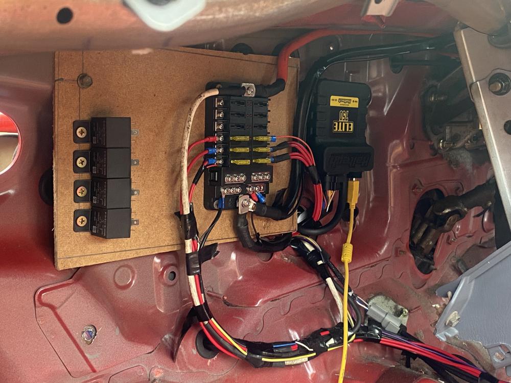

Thonfella259 Posted August 14, 2022 Author Share Posted August 14, 2022 Another update on the car🤘 It’s been a while since the last update, just been busy with work but I’ve been chipping away at it. my main goal is to make it as light and as simple as possible, so I’ve completely stripped the insides, door skins will be cut out as well as plastic windows, all lights will be wired from scratch (yet to do🚽). cool little centre piece I’ve made for the gauges and switches, made from the factory door card design🤌 As for the engine i’ve gone for a haltech elite 550 with a basic universal wiring harness, k20 coil packs, 4efte dizzy for the crank and cam trigger and I’m still running standard injectors for now, still need to get a haltech tps but I’m using the built in map sensor to get it fired up. All wiring will be covered with heat resistance tape so it’ll not be staying all exposed like that👌 Few photos here for all to see🤣 Quote Link to post Share on other sites

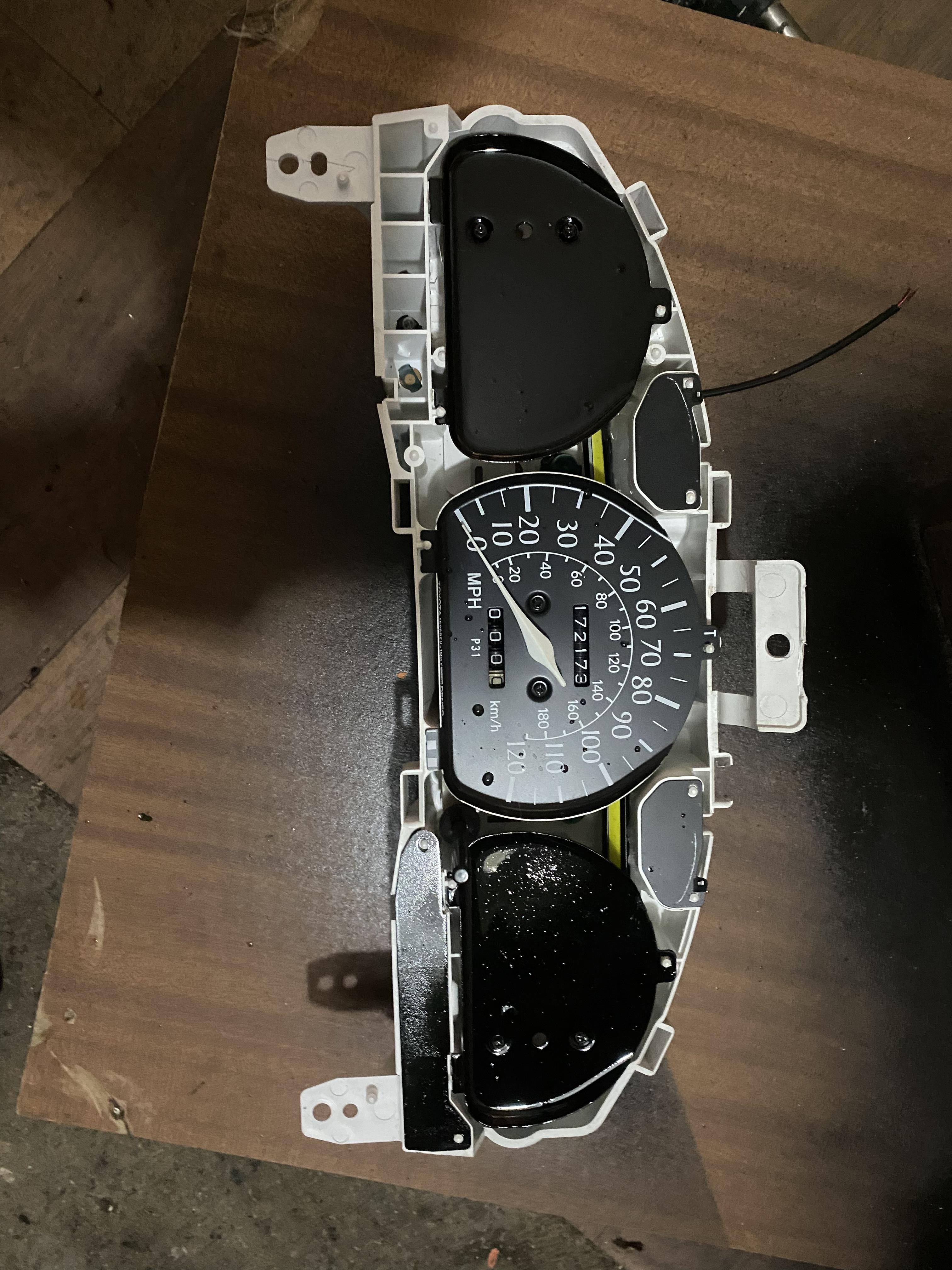

Thonfella259 Posted January 17 Author Share Posted January 17 Lil update, cold start dialled in and a shitty custom cluster delete thingy🤷♂️ IMG_0410.MOV Quote Link to post Share on other sites
