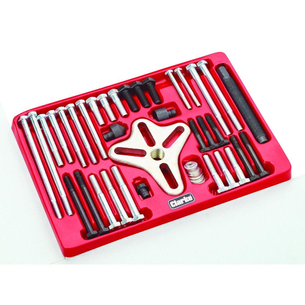

16 hours ago, akyakapotter said:
You need to push it off I used / use this.
0AA2EB74-C07D-4DEE-9E50-06F1EA18972F-huge.thumb.jpg.9ff7c69c50a00690b6e2f451153b12ce.jpg
Cheers nick.
Not if the harmonic dampener is not threaded.
I Just used a bearing puller.
So works in a similar fashion, but it uses claws.
I did have issues with it cracking the edges, ultimately I drove a metal wedge between the pulley and the engine block...
Right. My pulley has 3 small, non-threaded holes surrounding the big center bolt.
