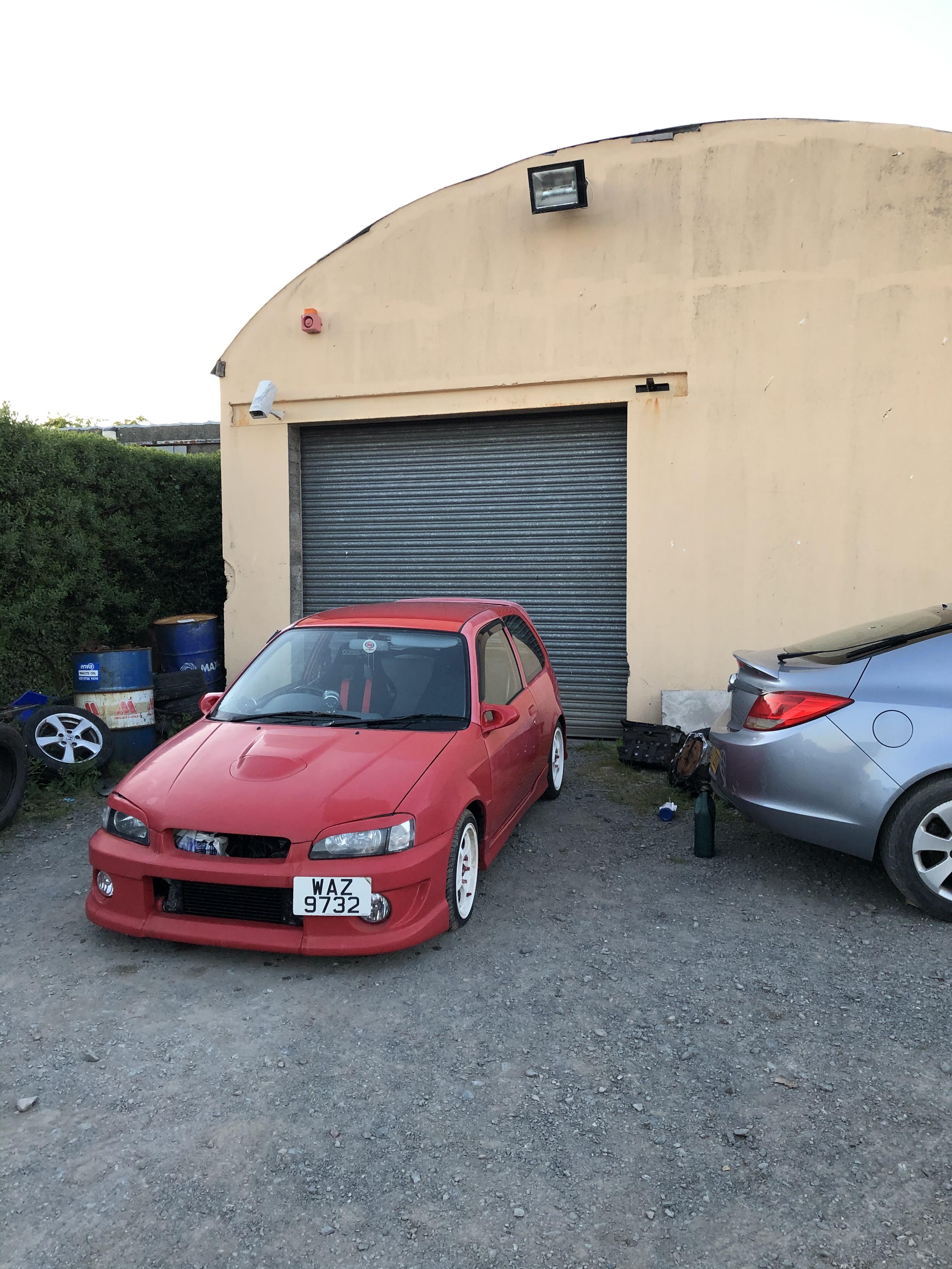

decky-320d Posted May 13, 2020 Share Posted May 13, 2020 Hi guys I’m back after about 6-7 years found a wee bargain so I had to buy it Plenty off goodies in it needs a good buff or painted but I’ll get there so the problem is 150 psi on cylinder 1,2 and 4 the needle wouldn’t even lift on cylinder 3 🙈 What experiences has others had with this ? I’m thinking a damaged piston but I’m hoping not lol Quote Link to post Share on other sites
akyakapotter Posted May 14, 2020 Share Posted May 14, 2020 Bet the ring lands have snapped off the piston. Welcome back to starlet ownership. Looks like a good one Cheers nick Quote Link to post Share on other sites
DRiiFTiE Posted May 14, 2020 Share Posted May 14, 2020 Ring or cracked piston Quote Link to post Share on other sites
SKINY Posted May 14, 2020 Share Posted May 14, 2020 My gt-four was very similar, cracked piston when it was stripped down Nice buy, Red is rare, must be 3/4 over here Quote Link to post Share on other sites
decky-320d Posted May 14, 2020 Author Share Posted May 14, 2020 Cheers for the reply’s guys, yea I’m thinking damaged piston but I really hope it’s just a case off new rings lol Anyone know off any for breaking round N.i ? Need a few bits including a drivers seat lol Quote Link to post Share on other sites
