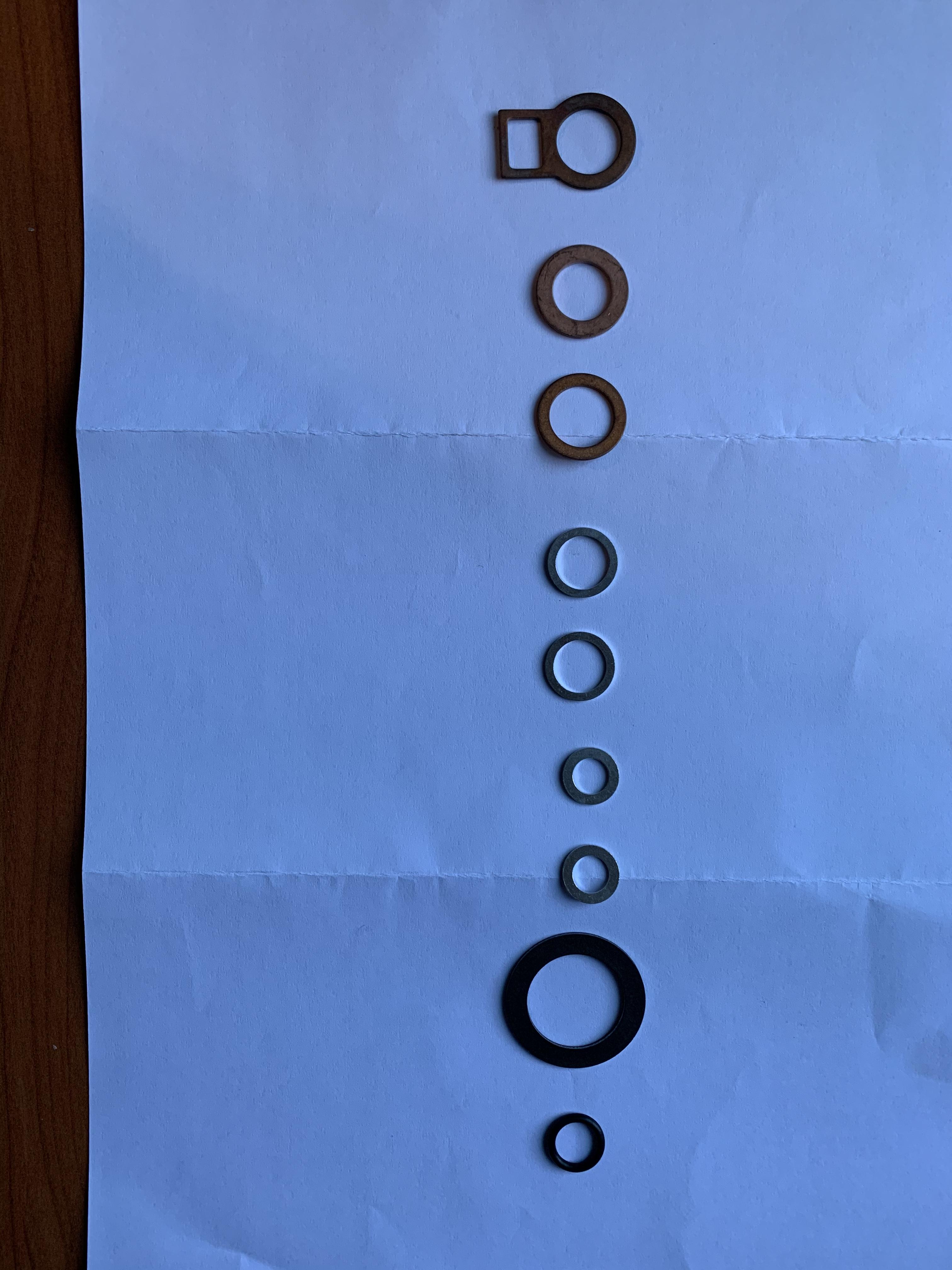

starlet1991 Posted May 23, 2020 Share Posted May 23, 2020 Can anyone help to locate where these seals from an oem engine gasket set go to? Quote Link to post Share on other sites
GP82 Posted May 24, 2020 Share Posted May 24, 2020 The top two are washers for the bolt on the oil filter housing feeding oil to turbo. The biggest one looks like washer that goes on oil filter housing, centre large bolt. The smallest ones look like injector nozzle seals and three and four from the top look injector collar seals. Quote Link to post Share on other sites
