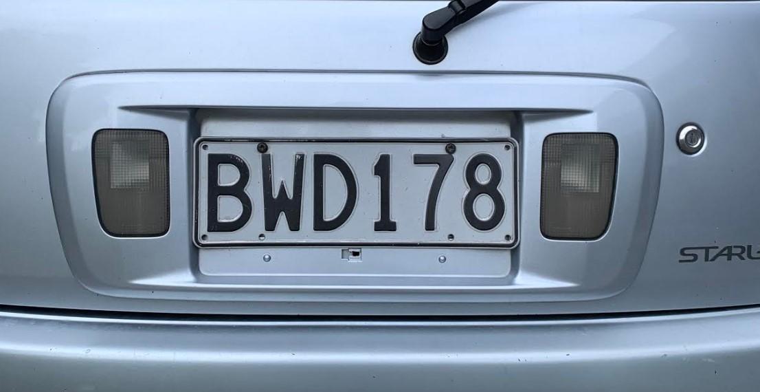

Hey guys,
Any tips on how to remove the plastic number plate surround on the boot? Mine has broken clips in places and is rattling around:
Cheers!

With the trim panel off remove the 2 10mm fixings. Then inside you can get to some of the clips to unclip it. Clips are easily bought online so if some break thats not a issue
