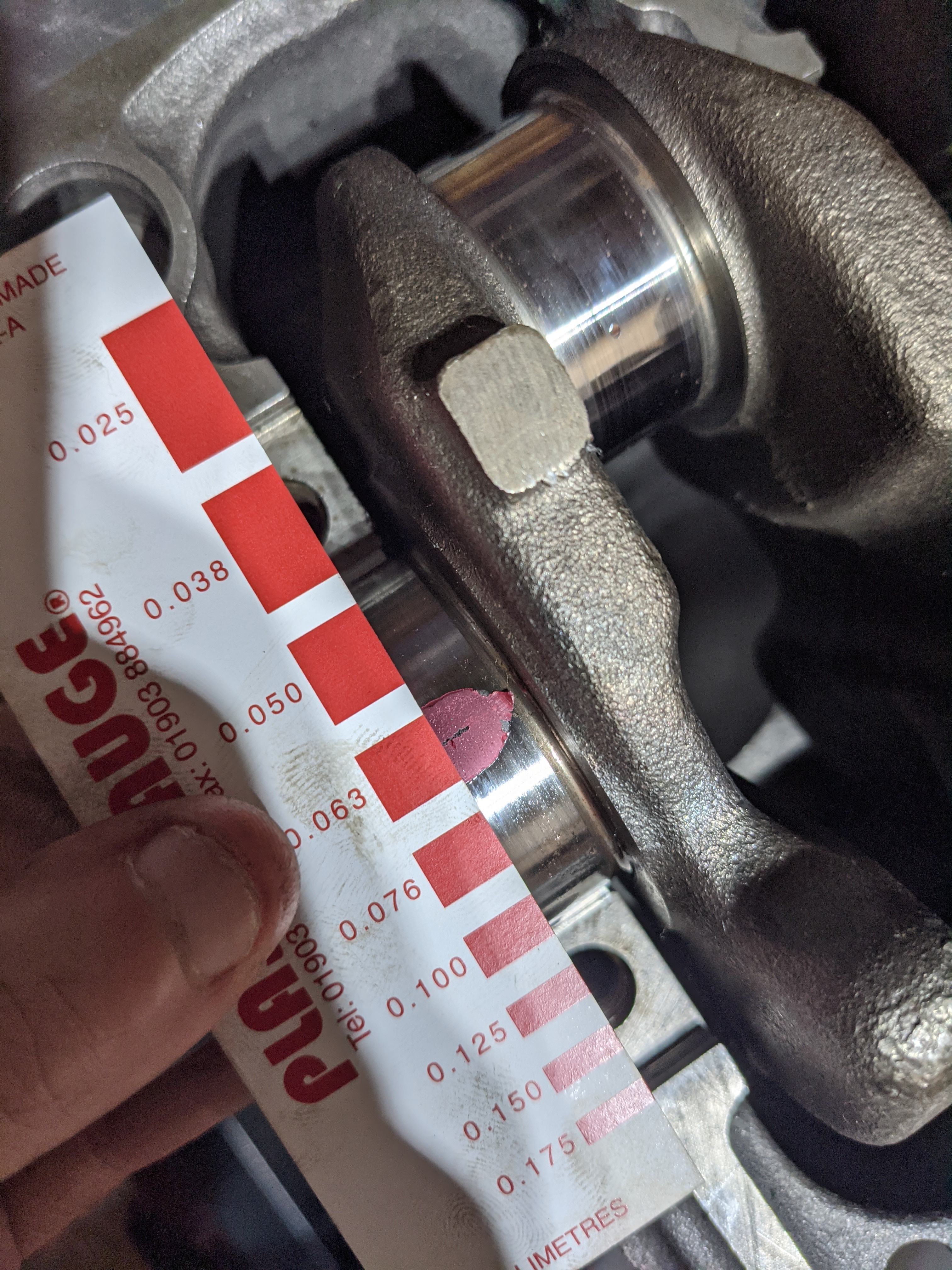

UPDATE!
So I've double checked my measurements with plastigauge to be on the safe side.
The readings I got on the plastigauge were matching up perfectly with my measurements! Below is a picture of the 1st lobe for clarification.
I've also installed piston 1 - I checked the ring gaps (using TP rings) - they were in tolerance. I also checked the tolerance with plastigauge and the reading I got was the same as my measurements!
