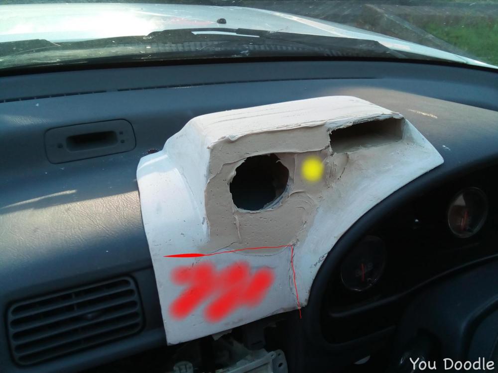

Sam44 Posted February 18, 2021 Share Posted February 18, 2021 (edited) I'm working on a warning lamp system built up of led lights to warn me (the driver) of any faults or danger levels with the engine, gearbox and fuel system, which are not monitored by the Toyota ep91 factory system Example: coolant level, coolant block pressure. Exhaust gas temp, det/nock alerts. Please feel free to join in and give me things to add to the system. I've made this dash mount to house the led indicators marked in red and yellow. Edited February 18, 2021 by Sam44 Quote Link to post Share on other sites

Sam44 Posted February 19, 2021 Author Share Posted February 19, 2021 (edited) im designing a cmos logic IC, there not really that pricey. its there to help me fault find, as well as give me instant warning to which system is faulty. i can also make them sensitive/progressive. i can also put things in the car in there like boot or doors open. i suppose the real danger zones i can put on a buzzer to, thanks thats a good idea. ive got room for about 20 square red led lights. there are afew items that are pricey, like the nock/det alert systems. Edited February 19, 2021 by Sam44 Quote Link to post Share on other sites
