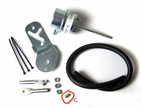

Giannis Posted August 12, 2021 Share Posted August 12, 2021 I want install the hks adjustable actuator and I don't know where the small in the red cycle used Any help? Quote Link to post Share on other sites
RoyalDutchie Posted August 12, 2021 Share Posted August 12, 2021 (edited) Seems to be a restrictor if it has the hole in it. Edited August 12, 2021 by RoyalDutchie Quote Link to post Share on other sites
