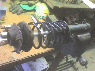

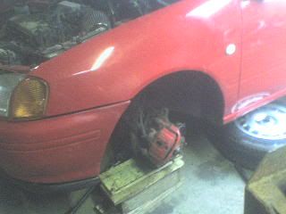

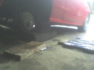

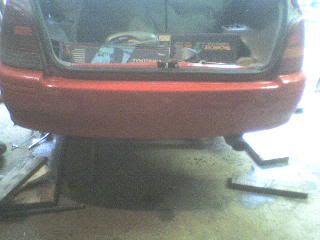

ZeroCool Posted May 28, 2008 Author Posted May 28, 2008 UPDATE..Got All New Springs Same Drop 60mm FRONT 45mm REARHere's Some Pic's Front Starlet EP91 Suspension...- Took Wheel Off Then Loosened Bolts In Engine Bay.- Then Loosend Brake Line On Shock-Absorber.- Took Both Main Bolts Out Behind Caliper.- Dropped Out the Full Supension.Looks Like this - Took Suspensoin Over To the Bench And Clamped It Up.- Loosend Bolt On the End Of the Shock Whilst The Shock Is Still Under Pressure. (makes Life Easy)- Clamped Spring Until it Was Loose Then Removed the Bolt And Holders.Looks Like This (These Are New Shocks by the way)- Clamp New Spring And Place On Shock.- Fit Into Place On Both Holders Top + Bottom.Looks Like This - Then Let Off Springs.- Tighten Shock Bolt As Tight As You Can.- Fit Back Into Place On Car.- Tighten Bolts.- Let Car Down.]- Re-Check Bolts.THERE YA GOOOOOOO....Rear Starlet EP91 Suspention...- Jacked It Up Just Under Rear Window Next To The Sus Hinge.- Undo Bolts Found Under The Cap In The Boot.- MAKE SURE THE REAR SHOCK ISNT UNDER PRESSURE AND THE LOWER BOLT COMES OUT EAST!!!!- When Taking Out Lower Bolt The Whole Suspension Will Drop Out.SAME PROCCESS WITH FRONT SUSPENSION Re-do Bolts And Yer Away Some Pics Of How I Done The Rear (lol)I Jacked Whole Rear End UpMy Rear Shocky Its Stiffer Than A Go-CartThought I Should Post Pics Of My Dash At Night (Check The Rev Counter )And Heres It With My Mates 17" on lolThere Ya Go MORE TO COME!!!!! Quote
