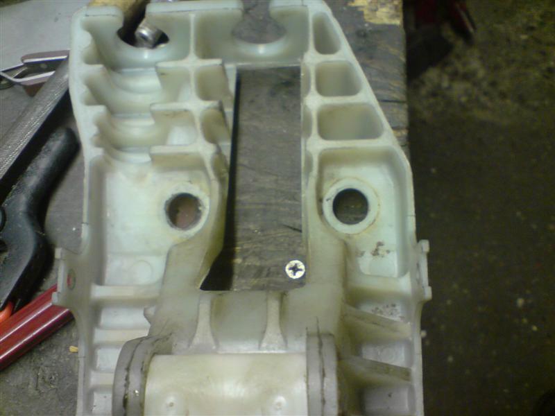

kevink Posted September 23, 2008 Share Posted September 23, 2008 *EDIT* i changed this first post into helpfull information for the people needing info on the TC Shortshifter installment*EDIT*PIECE TO CUT OUT(red box):THE BUSHES:SMALLLARGEPLACES FOR THE BUSHES(sideview, the box on the left is the dashboard):HOPE THIS HELPS PEOPLE! Quote Link to post Share on other sites
StarletRick Posted September 23, 2008 Share Posted September 23, 2008 you have 2 small ones on each at the back (one on the top and one underneath of each hole). then you have one small one on each at the front on the top. then you have 1 of the large bushes on each.you basically need to make it raised more at the back mate. swap em round and itll be sorted. you also need to cut the bit of plastic out of the tunnel for the cable, have you done that aswell? Quote Link to post Share on other sites

StarletRick Posted September 23, 2008 Share Posted September 23, 2008 yupchange them round so the 2 smaller ones underneath are at the back near the ebrake Quote Link to post Share on other sites
