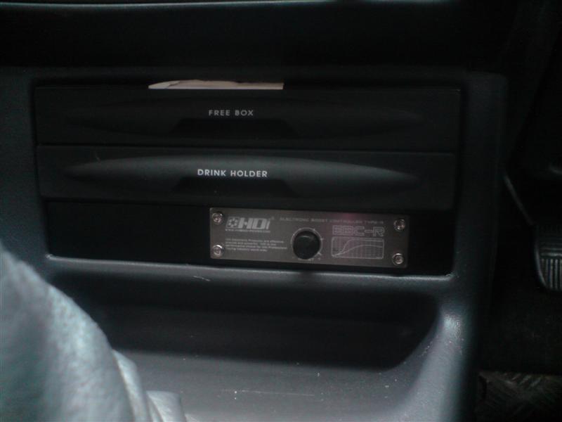

Toby@ToyTuning.com Posted January 12, 2009 Posted January 12, 2009 That looks ace buddy nice and neat job spot on.To add the AVCR is a very competent unit, full of features which won't always be used on a Starlet but well priced and they look grand. If your after something on a budget then consider they above or a used Greddy Profec B (the original one without a screen), these are basic, easy to use, can be installed in literally 10 mins and can be set up in 10 mins by yourself where as something like the AVCR needs to be done by a professional as they can be a little complicated.One thing I would advise is also purchasing an uprated actuator like our own ones or the HKS. The stock actuator can become week over time as the spring looses it's tensile strength, if it is worn then the EBC will never work to it's full potential. Boost which ever way you look at it is a mechanical process, things like EBC's and MBC's just aid the process. If the actuator is worn it won't be able to hold the boost as the wastegate will never be fully closed loosing vital pressure so the EBC won't have a hope in hell.Hope that helps,Toby Quote

Sparky Posted January 12, 2009 Posted January 12, 2009 HDi EBC-R, just fitted one to mine, excellent little unit, Dane (SPS) sells them What I was going to recommend Cheap and user friendly, contact Starlet_Bristol on here Quote
