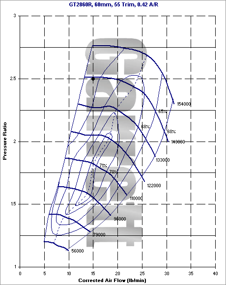

lobotomy Posted May 13, 2006 Posted May 13, 2006 Sounds like a very interesting project for sure!! I have found some Ford Escort RST seats (recaro)Are these the fishnet recaros like you find in some EP82 GT's, if so they are very cool!! If not, recaros are still cool One concern is the turbo. You often see this turbo used on 1800/2000cc engines, do you think the 1333cc will provide enough flow to get the best efficiency from the turbo? Have you plotted any data on a compressor map for the GT28R?And don't worry about your english, it's fine (better than the text speak that some people use on forums)Adrian Quote
klyfax Posted May 13, 2006 Author Posted May 13, 2006 Sounds like a very interesting project for sure!! I have found some Ford Escort RST seats (recaro)Are these the fishnet recaros like you find in some EP82 GT's, if so they are very cool!! If not, recaros are still cool One concern is the turbo. You often see this turbo used on 1800/2000cc engines, do you think the 1333cc will provide enough flow to get the best efficiency from the turbo? Have you plotted any data on a compressor map for the GT28R?And don't worry about your english, it's fine (better than the text speak that some people use on forums)Adrian<{POST_SNAPBACK}>I don't think those seats are the same.And for the Turbo, its a bit oversized, but its better to get a oversized rather then a undersize when we are talking bearing turbos.The Black dot is where I hit max. So it isn't that bad... Quote

lobotomy Posted May 15, 2006 Posted May 15, 2006 The Black dot is where I hit max. So it isn't that bad...Yeah looks ok, maybe a little close to the surge line, perhaps you'd suffer at lower revs, but then you'd be running less boost and there would be less of a pressure ratio. so it would stay within limits.At what RPM was that point based on? Where you hit max power so about 6500rpm?Adrian Quote
klyfax Posted May 15, 2006 Author Posted May 15, 2006 I'm aiming for 8000 rpms. With sharpen Cams...Tech. Info. Updated. (Engine) Quote
