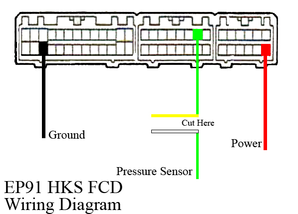

Russleh Posted August 4, 2009 Author Posted August 4, 2009 got hks fcon and gcc piggyback so been told the fcd aint a bad thing with those. the exhaust just sound like it misfires alot but the can just doesnt give at all after unless i give very little accelerator. i just need to know where the red n black wires go from the fcd. cant find the book for it. Quote

bucketep91 Posted August 4, 2009 Posted August 4, 2009 got hks fcon and gcc piggyback so been told the fcd aint a bad thing with those. the exhaust just sound like it misfires alot but the can just doesnt give at all after unless i give very little accelerator. i just need to know where the red n black wires go from the fcd. cant find the book for it.try the fcd first but i still think it sounds ignition related.this must be bursting your balls lol all these little nigley things. it will all be worth it in the end :harhar: Quote
Steve GT Posted August 4, 2009 Posted August 4, 2009 http://www.ukstarletclub.com/forums/index.php?showtopic=4987 Quote
bucketep91 Posted August 4, 2009 Posted August 4, 2009 thanks to dave burwash over on tgtt:ignore that^^^^just noticed thats for ep82 Quote

Russleh Posted August 4, 2009 Author Posted August 4, 2009 well the em light comin on for a few secs. exhaust poppin and a couple loose wires from the fcd is tellin me its fuel cut so ill try get the red n black plugged in tomorrow hopefully. saw the ep82 diagram but thanks a tonne for the on for the ep91 bucket. yes like you say its annoying especially when i started it and was like so lets test it and it just didnt do what i wanted but if i can get it sorted then ill be cheeeesin. ill update tomorrow. only updating my build thread when its working properly. cheers Russell Quote
bucketep91 Posted August 4, 2009 Posted August 4, 2009 just dont keep us waiting too long lolgood luck bud hope you get it sorted soon :harhar: Quote
Russleh Posted August 4, 2009 Author Posted August 4, 2009 dun dun dun :Pfinished . some idiot forgot to connect up the fcd properly. chaching. pictures tomorrow. celebration time. catchea Russell Quote
