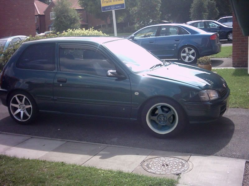

keirz Posted August 19, 2006 Posted August 19, 2006 ok being as indecisive as i am im unsure whether to change my alloys. the ones on the back are my current ones 16s that rub slightly. the front are 15s which are the ones i am thinking of gettting.opinions please,as i have changed my mind about 10 times now. also any insite into the benifits of the lightweight 15s over the 16s . thanks Quote

keirz Posted August 19, 2006 Author Posted August 19, 2006 can i have more info on the arch trimming. cuz took it to my bodyshop and they said it can't be done cuz of welding of the outer and inner panel. he could be lying but i can see where hes coming from. i had a look today with the hacksaw in hand, but could'nt find an angle of attack so left it. cheers Quote
tinman Posted August 19, 2006 Posted August 19, 2006 i just used a cuttin disc, in my mates toyota garage (which did help) & where the arch stuck out where the rubber was catchin i cut every inch & half then banged em back with a hammer holdin the outside body work to stop it dentin outwards, then resprayed it with rust proofin, as soon as i get mae camera back i'll post ya some pics of mine too if that helps its done the job on mine & no rustin too! i'm running 15x7 & its slammed fairly low Quote
Glanza_Ragger Posted August 19, 2006 Posted August 19, 2006 as tinman said, you get a saw, cut ever inch or so of the inner arch lip and fold them in on themselfs. gives you another inch ish or clearence for wider rims if your gonna be scraping the tarmac.alltho you shouldnt need to cut the arch , its a very easy job. takes a bit of care though .go for the 15's man, there the way forward. literally. jdm Quote

keirz Posted August 22, 2006 Author Posted August 22, 2006 thanks for the opinions, my wheels are 7" wide so prob rubs cuz of that. what is a good offset for starlets. i think mine are 40mm. the new 15s are 40mm as well and also 7" wide but i guess the extra half inch in the arch should stop the rubbing. will make it look more jap style as well. Quote
