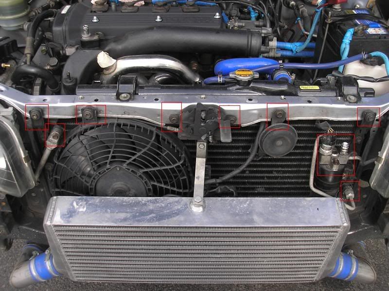

Jae-Glanza Posted November 30, 2009 Posted November 30, 2009 Intercooler arrived today and going to set about fitting it tomorrow! It came with a belt from toy tuning which i'm pretty sure is a non aircon belt. now I'm wondering if i HAVE to remove the aircon as i haven't prepared my self for that, just thought it would be tight with the aircon in! =]UPDATETo save making a new thread i thought i'd just edit my original. Today i fitted the intercooler, Fitted in with hardly any bumper cutting! HOWEVER, The turbo whine now sounds completely different, i'm not sure if this is normal or it's the intercooler leaking a little, and instead of a normal blow off from my shitty bailey, it also has a absolutely lovely flutter! i love in but thought this only happened running a really tight bov or no bov at all. Any ideas? Quote

Jae-Glanza Posted November 30, 2009 Author Posted November 30, 2009 Autobahn i'm lead to believe mate! Really cba to remove the aircon! Quote
Jae-Glanza Posted November 30, 2009 Author Posted November 30, 2009 Looks identical to the one in the 'removing aircon' guide, which has the fmic fitted before he removed the aircon.http://i2.photobucket.com/albums/y26/saxor...ON/P3170014.jpg Quote
Idrees Posted November 30, 2009 Posted November 30, 2009 It's an easy task to be honest mate. There is a tutorial that shows whats involved over on TGTT. Quote
Jae-Glanza Posted November 30, 2009 Author Posted November 30, 2009 Yea i dont mind doing it if i have to, but if i can avoid taking it out i'd much rather. where are you autobahn cooler owners? Quote
Dstillie Posted November 30, 2009 Posted November 30, 2009 no you dont have to remove the aircon, i fitted a hdi intercooler with air con in and that core is huge i also didnt have to modify any pipework... altho id recommend you get rid its easy enough and you will have loads more space to work with. Quote

WallaceGlanza Posted November 30, 2009 Posted November 30, 2009 no you dont have to remove the aircon, i fitted a hdi intercooler with air con in and that core is huge i also didnt have to modify any pipework... altho id recommend you get rid its easy enough and you will have loads more space to work with.The HDI has a different piping route though.... Quote
Jae-Glanza Posted November 30, 2009 Author Posted November 30, 2009 I'm pretty sure both sets of piping runs down the battery side of the engine bay. it has the dumpvalve exit right at the top of the all the piping which will result in my dumpvalve being central and at rocker cover height. if that helps folks?I think i can get away with keeping it after searching and a few response from here. Thanks chaps, mucho appreciated x Quote
dale10ellis10 Posted November 30, 2009 Posted November 30, 2009 Just for the input I managed to fit my Jp Performance intercooler kit without removing the air con but ended up having to get rid of it when I got my air filter relocation kit, so if your planning on relocating your filter which is a must if you want any kind of performance gains then get that A/C removed Dale. Quote
Jae-Glanza Posted November 30, 2009 Author Posted November 30, 2009 Thanks dale, Expect i'll fit the cooler if i can without removing the aircon for the minute, then next week with a week off from work i'll take that aircon out!Thanks folks! Quote
dale10ellis10 Posted November 30, 2009 Posted November 30, 2009 Thanks dale, Expect i'll fit the cooler if i can without removing the aircon for the minute, then next week with a week off from work i'll take that aircon out!Thanks folks!No worries, the main issue with my intercooler was the pipe that comes from the turbo and heads downwards to the drivers side of the car, you've got to cut the plastic side cover ( if you still have one ) and the aircon pipe sits right where the pipe wants to go. But obviously with a little delicate bending it cleared it This depends on the make and route of your intercooler pipework.But just a heads up Quote
