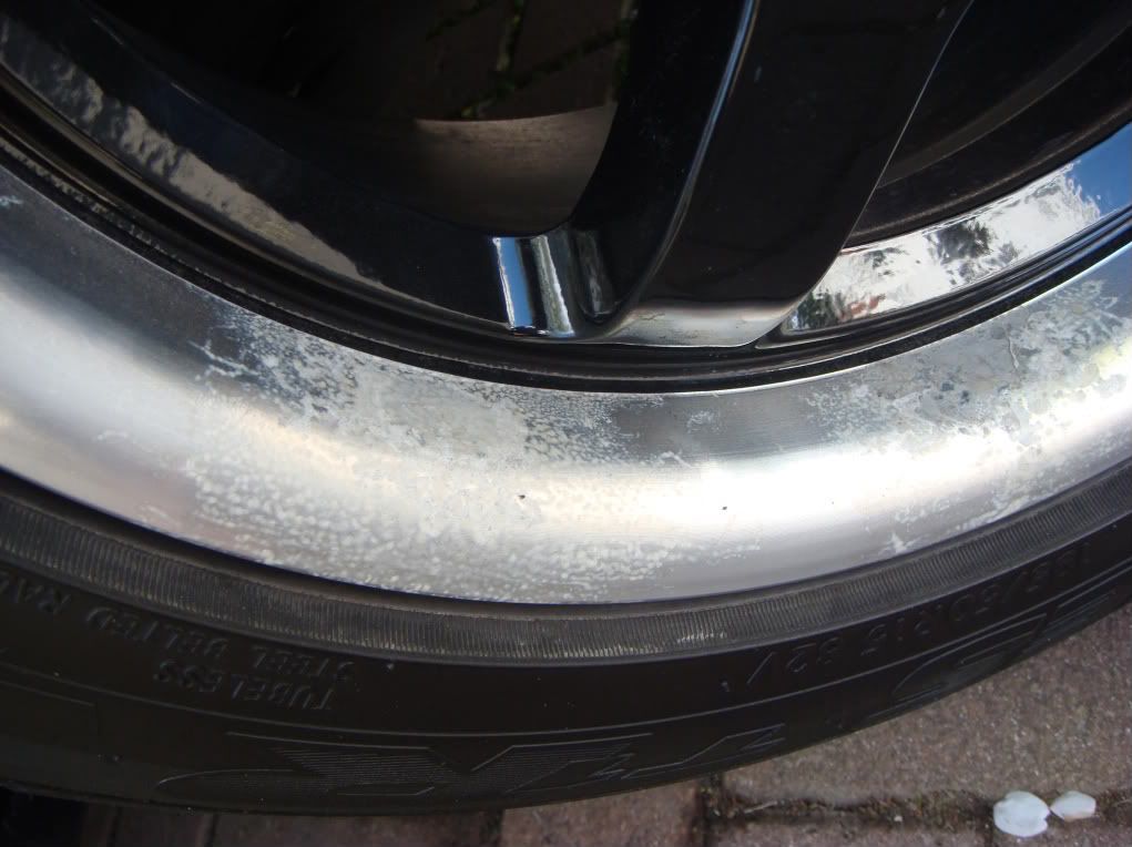

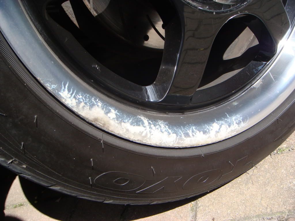

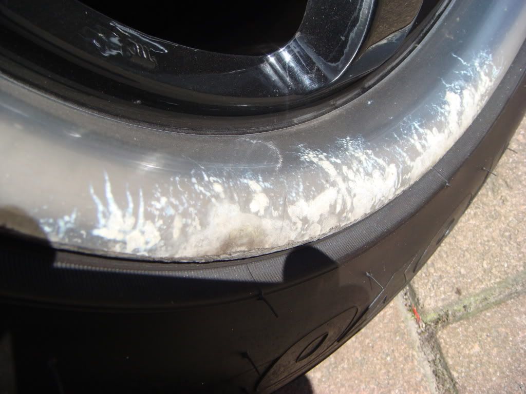

Amjad Posted April 20, 2010 Posted April 20, 2010 Hey guysI was wondering if anyone could offer any advice on how to refurbish a Chrome rim? I've been told to use 1200 Wet & Dry/Steel Wool/Autosol but I've got no idea in what order and what exactly to do 3 of my wheels have pretty bad lacquer corrosion, but it's not the whole way around the rim, here's a few pics to show you what I meanThe spokes etc are fine as you can see, I just want to restore the rims to their former glory! I'd appreciate any help ThanksAmjad Quote

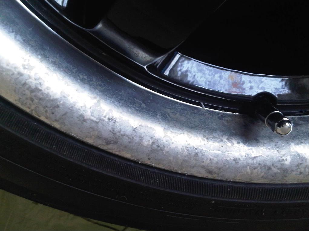

The Toffinator Posted June 24, 2010 Posted June 24, 2010 Best thing to do mate is use whatever you can to get it back to bare metal, polish it like mad then relaquer it, i did a set of wheels before, with nitromors! that works great, but obviously you would have to tape the spokes up, dont want it on there! Quote

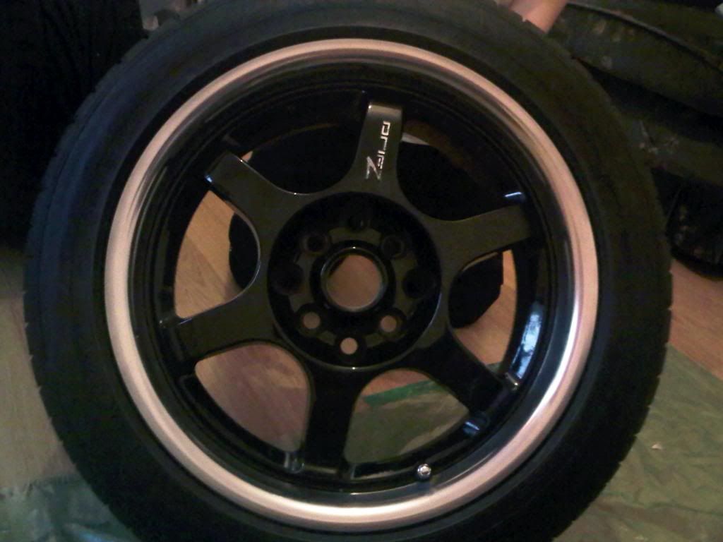

Amjad Posted June 24, 2010 Author Posted June 24, 2010 Thanks for the tips guys, I did actually manage to get it done a while back now..Nitromors is the shiz!Before: After: Quote
