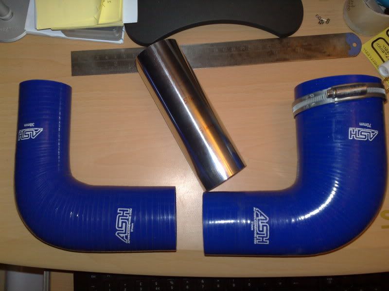

Josh@TunerLifestyle Posted June 11, 2010 Author Posted June 11, 2010 ahh so two elbow are needed? u got the sizes mate? Quote
addz Posted June 11, 2010 Posted June 11, 2010 ahh so two elbow are needed? u got the sizes mate? 38mm (turbo side) to 51mm51mm to 70mm (70mm as my Apexi filter is a chunk)51mm alloy pipe to connect the two 51mm hoses.Expand picture, the sizings are in small print Hope that's of help Quote
Josh@TunerLifestyle Posted June 11, 2010 Author Posted June 11, 2010 more than enough help bud i found some 48mm tubeing at work so il work with that ;) as long as i get the 38mm turbo side ok and the side that works well wit my filter im guna buy it should be all dandy air con came out 2nite all ready for it!cheers guys Quote
