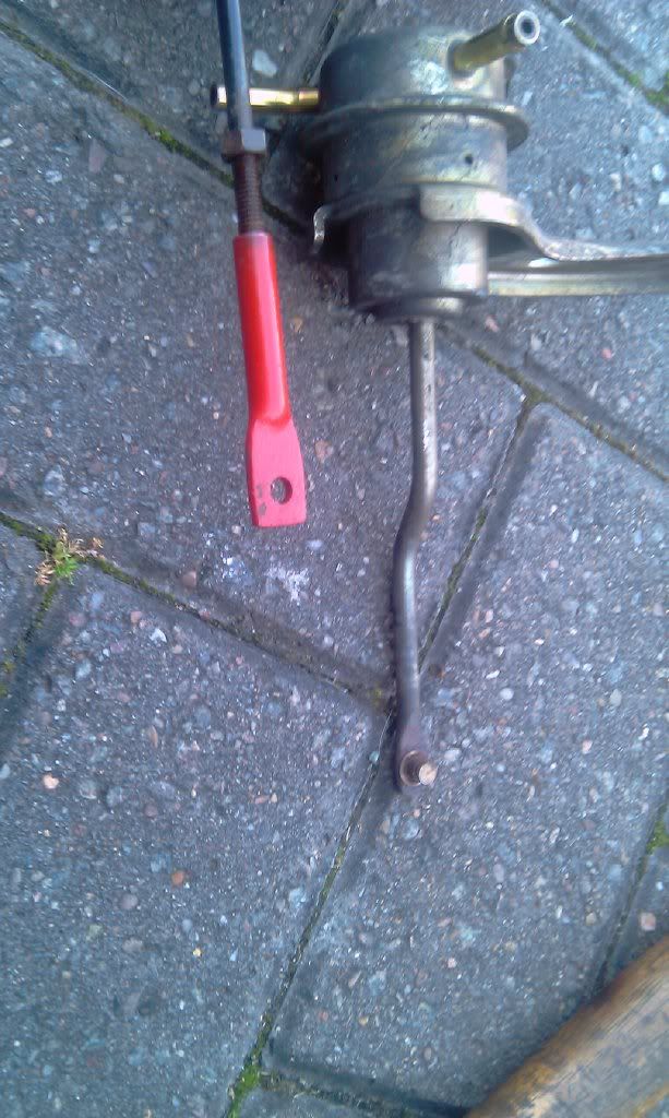

Josh@TunerLifestyle Posted June 15, 2010 Posted June 15, 2010 basicly im trying to fit my acturator and i cant see how the pin ( c clip thing comes off the old one, here is a pic :please can anyone help as im fitting 2nite and wwana get it done before dark cheers josh Quote

WallaceGlanza Posted June 15, 2010 Posted June 15, 2010 You've got the wrong type of actuator arm you need the pin type for a glanza. However you can use a bolt as long as it's a slightly loose fit (there arm pivots around the pin slightly so too tight and it won't move) or get a pin with a circlip either end. Quote
Josh@TunerLifestyle Posted June 15, 2010 Author Posted June 15, 2010 dayym! didnt no there was diffrent types =L a nylock would melt wouldent it? and i spose its the only way i can do it .. bodged as usual lol rite il have a look.. wish me luck! Quote
