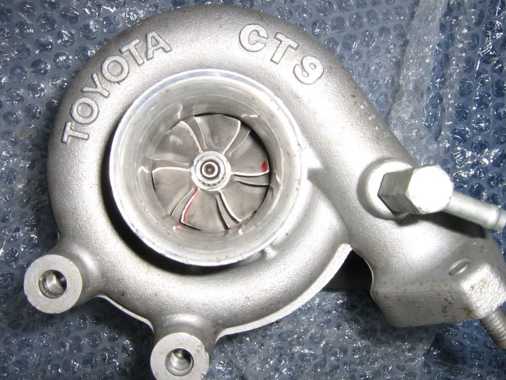

micky boy Posted August 25, 2010 Posted August 25, 2010 Just to add..the first link isnt a Tongs hybrid!! Quote

QuickNick Posted August 25, 2010 Author Posted August 25, 2010 Just to add..the first link isnt a Tongs hybrid!!Yes it is, look further down the page.... Quote
micky boy Posted August 25, 2010 Posted August 25, 2010 Yes it is, look further down the page....The one on the right dosnt look like a Tongs turbo, the turbine blades looks diffrent!!!Pluss the flange where the intercooler pipe bolts to hasnt been welded all Tongs turbos arePictures: Quote

QuickNick Posted August 25, 2010 Author Posted August 25, 2010 The one on the right dosnt look like a Tongs turbo, the turbine blades looks diffrent!!!Pluss the flange where the intercooler pipe bolts to hasnt been welded all Tongs turbos arePictures: Well i'm just going on what the advertiser said it is, perhaps it is an older model of TONG Hybrid as I understand they have developed them further over the years. Quote

bucketep91 Posted August 25, 2010 Posted August 25, 2010 i think that is a tong hybrid micky, the older G spec hybrid. i had 1 of them Quote
