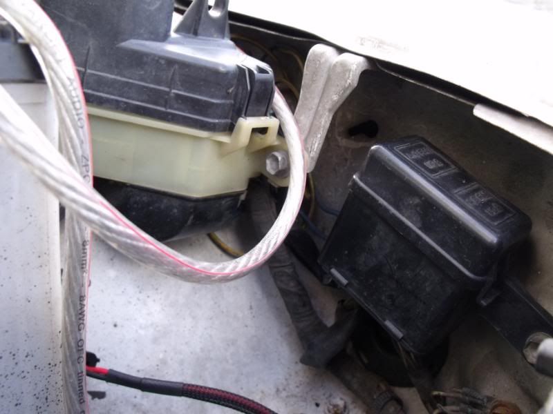

I tryed to bridge mine but didnt work so jus left the plug on...
Hear is the plug...
An tucked out the way...
