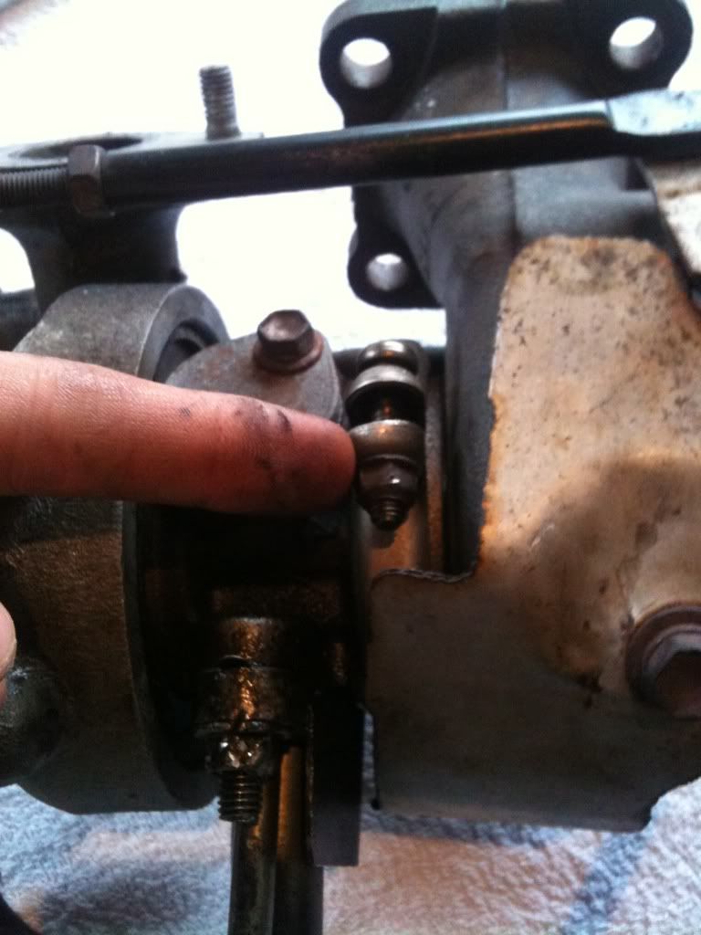

N80Jamie Posted February 25, 2011 Author Posted February 25, 2011 Is it this that i need to undo to rotate the turbo? Quote
Sparky Posted February 25, 2011 Posted February 25, 2011 From memory mate yes, just slacken it off and tap it with a rubber hammer, you wont need to move it much so that should do the trick Quote
N80Jamie Posted February 25, 2011 Author Posted February 25, 2011 hmm, ive just removed that clip and still cant seem to budge the turbo lol. Quote

string Posted February 25, 2011 Posted February 25, 2011 if you've undone the bit your pointing too then i think you've done it wrong. yes you may get clearance but you'll also move the oil return from pointing straight down. personally i'd undo the circlip on the back of the compressor and rotate that way. could be wrong though. Quote
nazzurro19 Posted February 25, 2011 Posted February 25, 2011 if you've undone the bit your pointing too then i think you've done it wrong. yes you may get clearance but you'll also move the oil return from pointing straight down. personally i'd undo the circlip on the back of the compressor and rotate that way. could be wrong though.thats the way i was told to do it, take off the circlip n hit it round with a hammer Quote
string Posted February 25, 2011 Posted February 25, 2011 dunno if ct9s have a locating pin in? that miht need taking out but yeah circlip off and it prob will move round enough without taking apart. Quote
