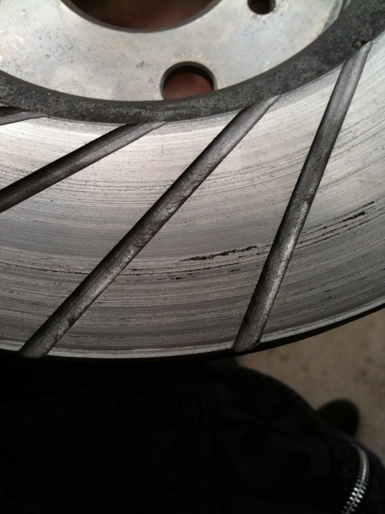

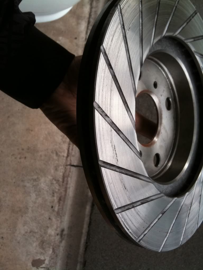

N80Jamie Posted May 14, 2011 Author Posted May 14, 2011 Took the discs off and found this on the inside! :|]The shit shield has been scraping loadsss, that's what has been making the noise! (Streetracer Starlet thankyou!) Please don't tell me these discs are foooked? Quote
N80Jamie Posted May 14, 2011 Author Posted May 14, 2011 Thats just a scuff, discs will be fine Thank god! haha. I'm unsure what i can do to move the backing plate away from the disc :| Any suggestions? Quote
Liam_D Posted May 14, 2011 Posted May 14, 2011 Yeah they'll be good mate, they'll unscore after a bit of braking. Glad its sorted mate. Quote
