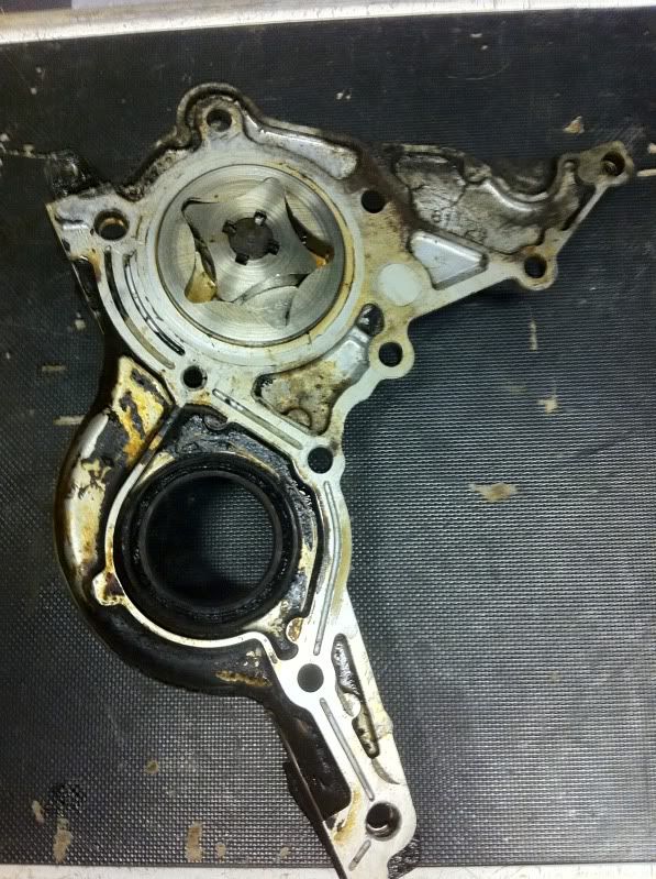

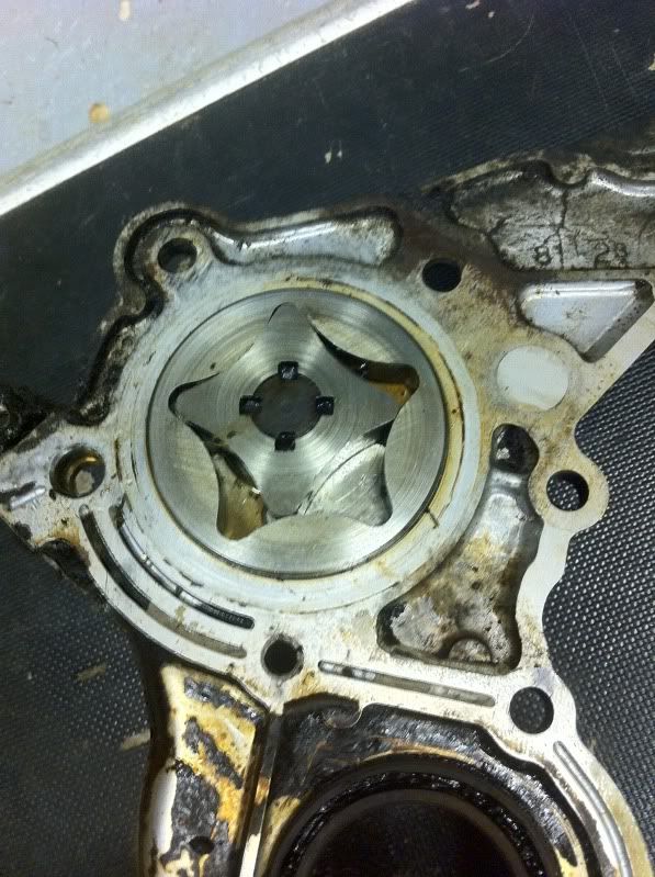

Jamie1st Posted June 13, 2011 Posted June 13, 2011 Hey, yeah another question from me :/ Is there only two types of oil pumps? - One with the seal part of the pump, and one with the seal on the block?The reason I'm asking this is because I also read somewhere that some have ridge/cut out/lip around the pump part its self, where as others don't?Here's some pictures, it's taken from a 1996 Glanza V, however, it could have an earlier/different type engine in for all I know, after all, its 15 years old!If anyone could help, that would be great, just want to order the right one for my forged build!JamieCheeers! Quote
Sparky Posted June 14, 2011 Posted June 14, 2011 If thats a groove on the back then thats the pump with the seal on I made the mistake of buying the wrong one lol Quote
Russleh Posted June 14, 2011 Posted June 14, 2011 try not to confuse ya like i confused sparky lol. goin by those pictures your seal will be on the block. there are only 2 types. either have a groove in the pump for the o ring o a grove for the oring in the block. remember youll need to buy the oring seperate. YOU NEED AN OIL PUMP WHERE THE SEAL IS IN THE BLOCK lol. ( incase i confused ya ) Russell Quote
Jamie1st Posted June 14, 2011 Author Posted June 14, 2011 Good job I posted this, I was going to order one with the seal in the pump!Cheers all of you!Jamie Quote
