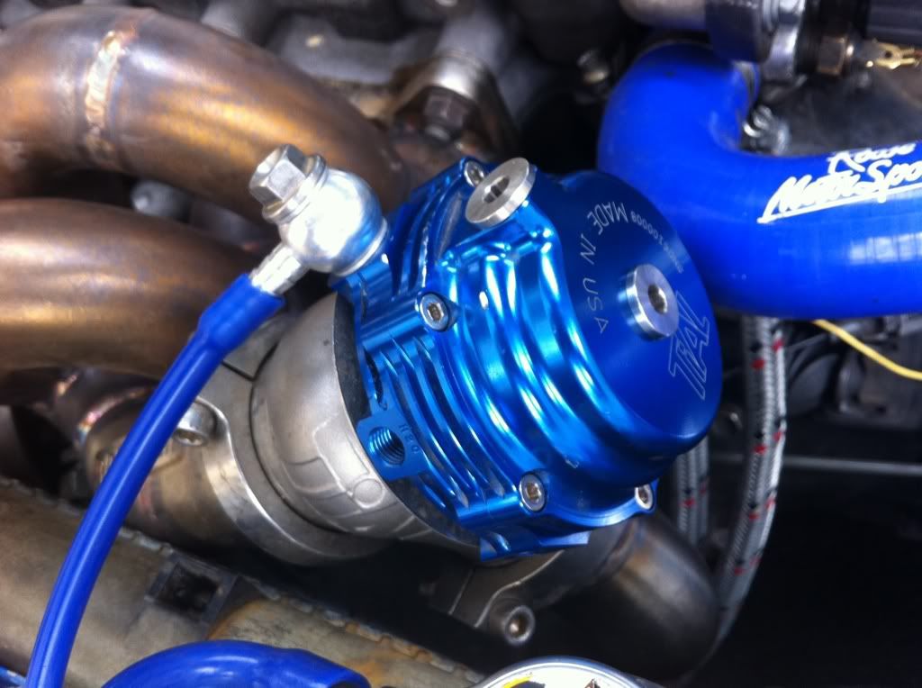

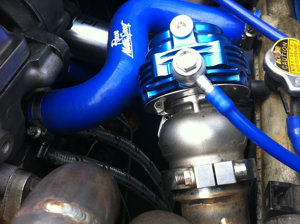

Idrees Posted July 6, 2011 Posted July 6, 2011 I've tried all sorts with the vac lines but nothing is curing the over boosting. I've tried both springs that were originally inside the wastegate individually but still too much boost. I've found that this is the way I should be set up to run off the wastegate spring pressure, which is 0.7 bad according to Tials website, I've used the thinner soft spring now but it still reaches 1 bar of boost. Opened up the wastegate and that seems to be opening and closing properly too, have I done something wrong here?! Also the vac lines are not leaking as I've checked it. I've tried to vent either top ones to atmosphere too but still no helpStraight to the compressor housing Quote

Ryan Posted July 6, 2011 Posted July 6, 2011 i have the same wastegate as that mate. In your first pic you have the air fitting attached to the bottom port but the one above is blocked off with a blanking screw. Have you tried removing that and let it vent then take the car for a spin and see if that does it Quote

Ryan Posted July 6, 2011 Posted July 6, 2011 wastegate wont fully open till it hits the boost that its targeting. I had the same problem with the two springs but i put one back in and it boosted alright at 0.9 after that Quote

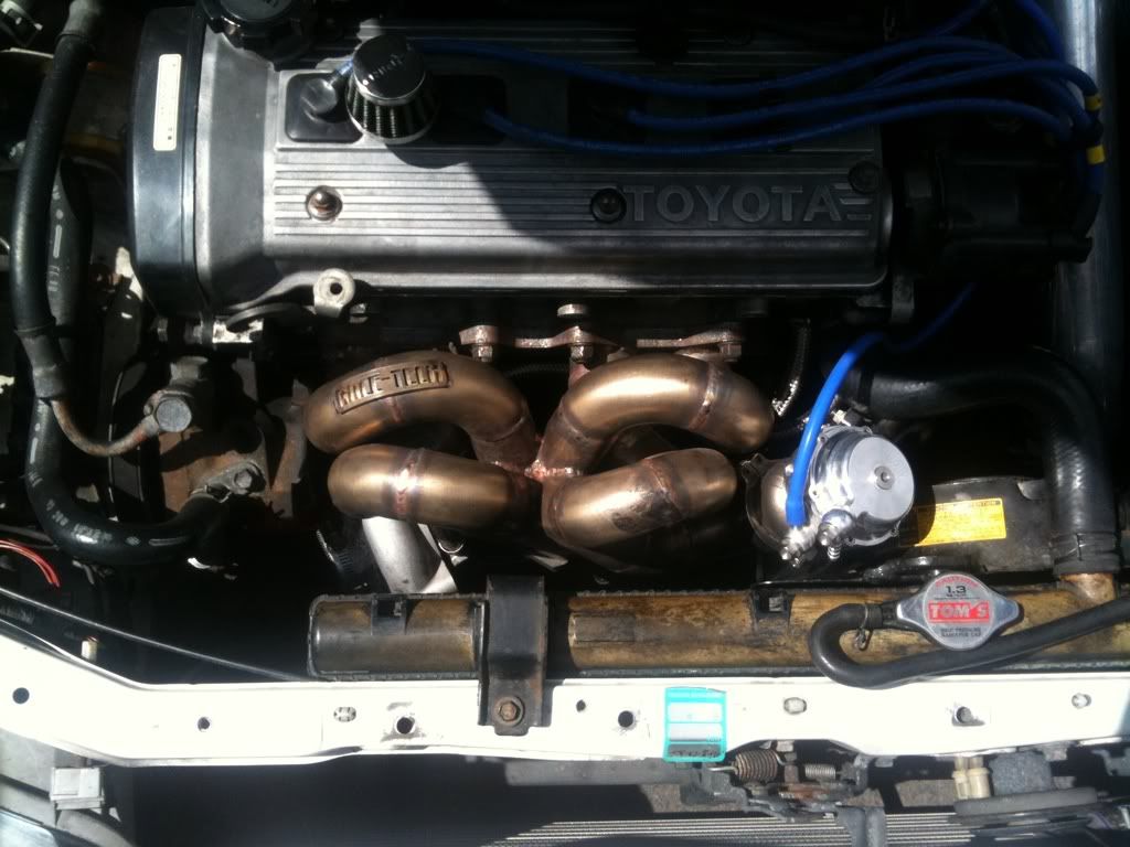

Ryan Posted July 6, 2011 Posted July 6, 2011 Got the wastegate on the wrong way then by the sounds in that pic its the right way round. But if he has it the wrong way round thats his over boosting problem Quote
Idrees Posted July 6, 2011 Author Posted July 6, 2011 Can you tell if it's fitted wrong by looking at these pictures? Quote

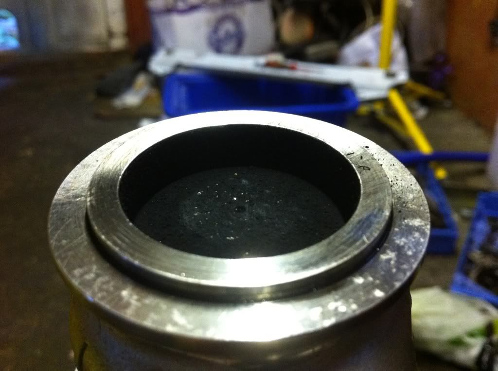

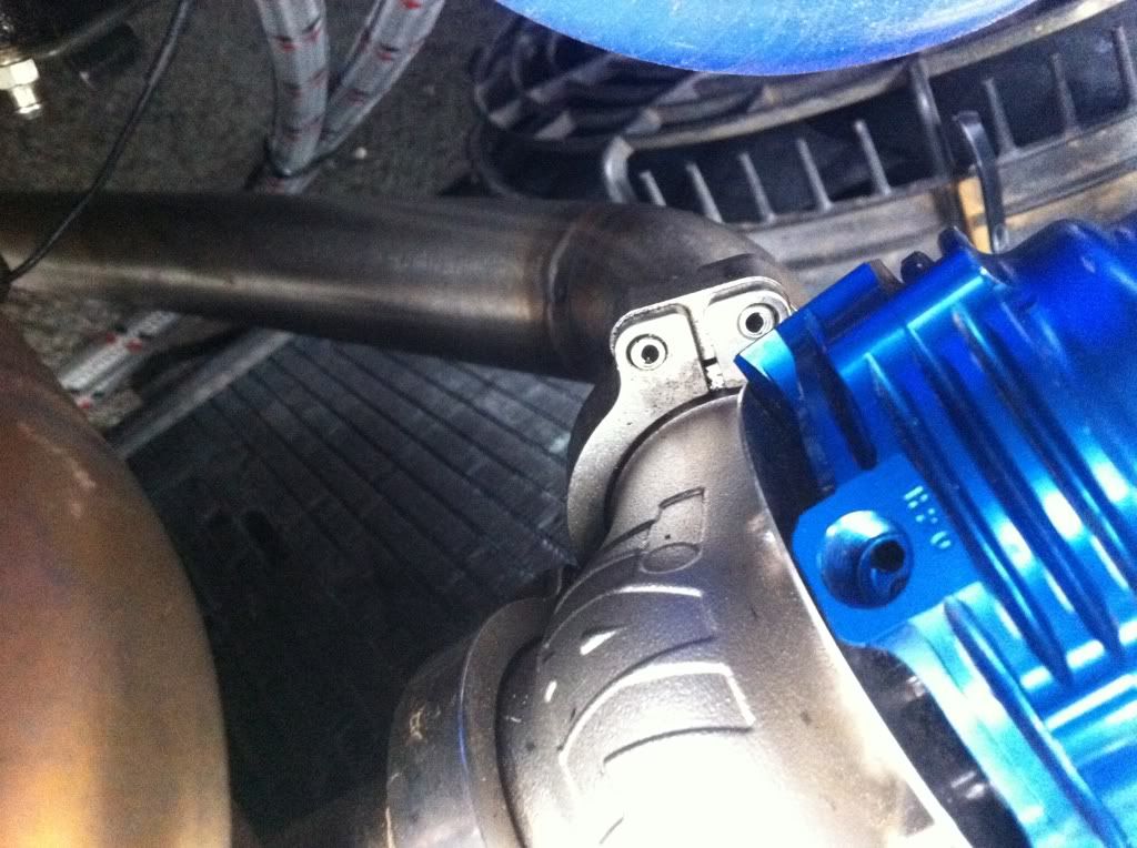

Idrees Posted July 6, 2011 Author Posted July 6, 2011 I've removed the wastegate and it only fits one way, so the flanges are welded wrong on the manifold and screamer if it's the wrong way, and that's quite unlikely!Just to confirm:Manifold side:Screamer side: Quote

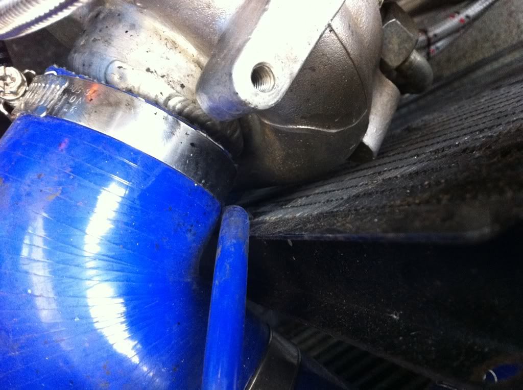

Idrees Posted July 6, 2011 Author Posted July 6, 2011 Another thing I've noticed is there's 4 threaded holes on the bottom side of the wastegate, 2 are the top ones as pictured but the bottom 2 near the screamer are left open as I wasnt supplied any blanking plugs. Do they need to be blocked off? Looks as if they should be blocked. Quote
nazzurro19 Posted July 6, 2011 Posted July 6, 2011 i was guna say have u put the coller on the manifold side , which ya have so its all fitted ok , i have only got two ports on my wastegate top , n bottom where as you have four its probs letting all the pressure out so a massive boost leak i woulda fort Quote
Ryan Posted July 6, 2011 Posted July 6, 2011 if my car was here mate i would have took a few pics of mine as its the same race tech kit. But its away get MOT stuff sorted Think all unused air vac ports should be blocked up. PM Ricky he should shed some light on it Quote
Sparky Posted July 6, 2011 Posted July 6, 2011 The other ports are just water ways arent they? So wont effect the boost at all Quote
MARK@CMBAUTOS Posted July 6, 2011 Posted July 6, 2011 The other ports are just water ways arent they? So wont effect the boost at allyes they are water waysid def say the top hole shuld be vented tho Quote
