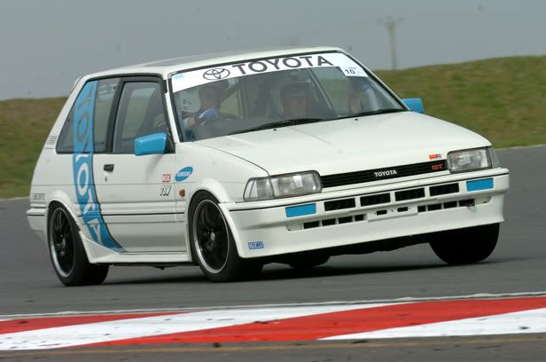

Keri-WMS Posted July 27, 2011 Posted July 27, 2011 Hi Lee, welcome to the club! You may like this - the 1.8 190bhp 16v lump from the Gen 7 Celica 190 into Starlet swap: http://www.ukstarletclub.com/forums/index....showtopic=34821There are a couple of lads locally to me with a nice track-only AE82 I supplied a 4-pot brake kit for, thought you might like: www.ae82.net/showthread.php?2767-track-day-pics-reportStarlets are like the AE82 in that they are both 4x100, but also are both a 54.00mm bore where the wheel sits, so your wheels want to be 54.15mm bore, or at least that's what any adaptor rings should be. Quote

16v_paddy Posted July 27, 2011 Author Posted July 27, 2011 Hmmm seems I've been misinformed, always been under the impression that the silver tops were 170bhp & the black tops 180bhp, oh well.Loving the 190 conversion but the lack of ITB's puts me off a bit lol! I'll certainly keep an eye on thatI must admit 838kg is a bit of a disappointment though, thought more could be taken out, but I am basing that on what I know about the clios, a mate has got his down from the std 1000kg to 790kh with him and some fuel in it. I've had a look at taggys as suggested & think EP82 is probably the better option for this build but we'll just have to wait & see what shells are available when we're ready to make a start on the project.Love that AE82 track car I miss mine soooo much The renault wheels are also 4x100 but the bore is 60mm so some spigot rings in the right size will save me a few quid in not needing to buy more wheels & tyres alright paddy, seen the light boost is best, hows the clio going?EllzCome on Ellz you should know me by now, I'm strictly an N/A man now, only gonna be having boost for my boring daily driver ;) The valver's still going strong, had to put a new bottom end in as the rings had gone but she survived a 100mph spin at Castle Combe a few weeks ago, got a decent outing at Donington Park on monday and will be getting a pasting at Oulton Park on the 24th august. Everyone that's driven it on track so far has been very impressed with the F7P & Jenveys combo Quote
