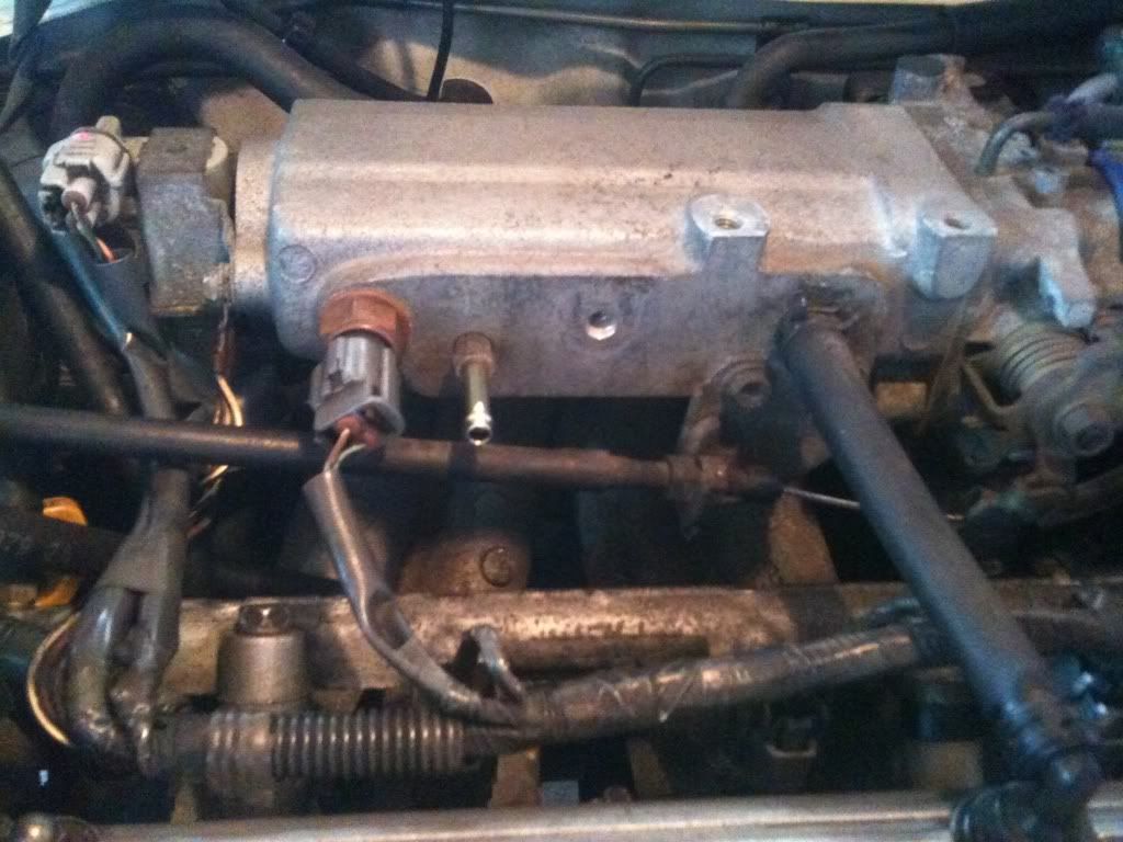

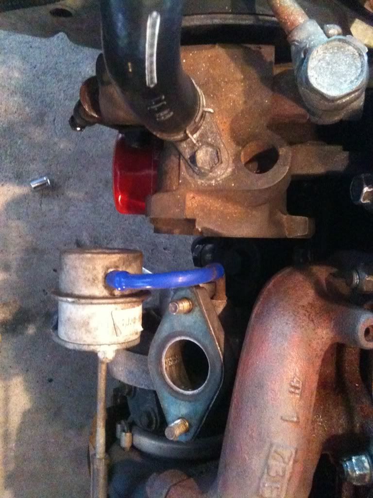

N80Jamie Posted August 27, 2011 Posted August 27, 2011 Last steps to getting the car up and running now and just need to know if what I've done is right. First off, I've got a Jose going from the turbo to actuator, pictured below:Is this all that needs connecting to get boosting? Secondly, do I just blank this port off on the inlet?Thankyouuu Quote
DavidAshton Posted August 27, 2011 Posted August 27, 2011 Turbo will run off actuator presure like that so its fine. The nipple is for the bob so if your not running one it can be blocked. Quote
Jamie1st Posted August 27, 2011 Posted August 27, 2011 Your turbo looks right. That other port on the inlet, I have a vac hose going to it from my BOV, with another T-piece to my Gauge.Hope this helps, Jamie Quote
N80Jamie Posted August 27, 2011 Author Posted August 27, 2011 Cheers for the quick replys! Running no BOV and there is no boost gauge anymore so it shall be blocked off Quote
