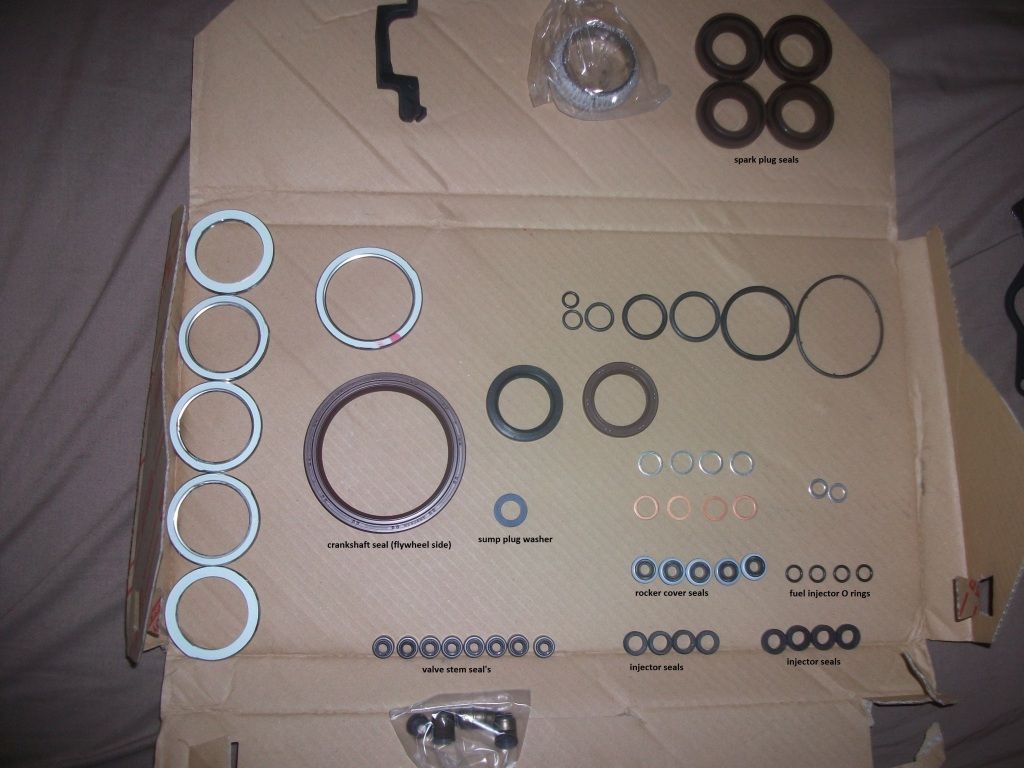

got my 5e rebuild kit but a few of the gaskets am clueless what they are lol. any one tell me what the ones with out names are? also has anyone ordered spark plug seals / and injector seals recently and remeber the price? i renewed them all few months back and the price on them was stupid but i got them with a pile of other parts.
think the two on right of the crankshaft seal are camshaft seals....1-2 of the small O`rings mabe for the fuel pressure regulator...theres a exhaust gasket there too and what looks to be part of the timing belt cover seal?
yea was thinking those 2 were for camshafts wasnt sure why they were diffrent colours tho. that thing that looks like the timing belt cover isnt its a small bit of rubber clueless to what it does but i have the timing belt cover seal in a seprate box along with rest of the bigger gaskets
one of the rubber o-rings are for the distributor seal, at a guess id say 3rd from the right
copper washers are most likely fuel rail related
I think they are all right. I might have the distributor and water pump the wrong way around. Not sure what the 2 small metal washers are for.
Edit: I think the power steering pressure pipe will only use 2 of the washers on one end and I bet the other 2 are for temp sensors (water and air or both water).
