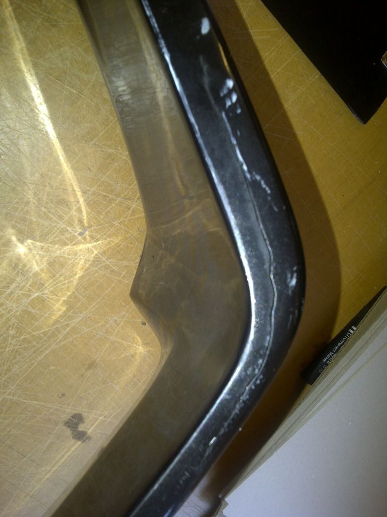

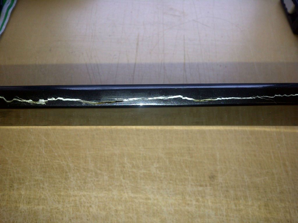

mattyD Posted July 3, 2012 Posted July 3, 2012 (edited) my Jam spoiler Edited July 20, 2012 by mattyD Quote
Idrees Posted July 3, 2012 Posted July 3, 2012 It is repairable. But it's most likely a matter of time before the same cracks show. Quote
mattyD Posted July 3, 2012 Author Posted July 3, 2012 how would you go about it? been reading up and apparently epoxy is good stuff or should i take it to a body shop and get it done properly? or not at all? lol Quote
rinseep82 Posted July 3, 2012 Posted July 3, 2012 depends how much they would charge to repair it if its too much just get another spoiler up to you really bud Quote
Idrees Posted July 3, 2012 Posted July 3, 2012 If I was to have it repaired I'd have it done by a bodyshop. Saying that though, I personally wouldn't bother due to the amount it'd cost and the fact that it will most likely appear again as you'll always be opening/closing the boot. Who did you buy the spoiler off? PM me if you like. Quote
triple j Posted July 3, 2012 Posted July 3, 2012 i would fill the gaps with isopon, put a good strip or two of fiber glass just over the cracked areas, then i would isopon it back in to shape wit the least amount if isopon possible, its a bit of work but could end up sound. Quote
mattyD Posted July 4, 2012 Author Posted July 4, 2012 depends how much they would charge to repair it if its too much just get another spoiler up to you really bud to be fair, I wouldnt be paying for the repairs as i should be well within my rights to get the money back i paid for the spoiler plus its a rare genuine item so would be quite hard to come across another If I was to have it repaired I'd have it done by a bodyshop. Saying that though, I personally wouldn't bother due to the amount it'd cost and the fact that it will most likely appear again as you'll always be opening/closing the boot.Who did you buy the spoiler off? PM me if you like.I'll see if i can get a quote off a couple of places and see what they say with regards to it holding aswell and to be fair, once it is fitted (if it gets fixed) i will hardly be using the boot as it will be primarily used as a weekend/track car I bought it from a guy off ebay, i'll PM you now mate Filler or spray foam and fiber glassi would fill the gaps with isopon, put a good strip or two of fiber glass just over the cracked areas, then i would isopon it back in to shape wit the least amount if isopon possible, its a bit of work but could end up sound.Cheers guys never thought of that would it maybe be a strong enough hold? Quote
pick1 Posted July 4, 2012 Posted July 4, 2012 Worth keeping if genuine mate for sure ,it will probablyNot be a particularly cheap job to get it minty fresh again though mate but IMO I would take it to a body shop Least then u have some one to turn to if something goes wrong n your not kicking urself lol Quote
kbond Posted July 4, 2012 Posted July 4, 2012 Would be an easy repair at any good body shop budIf no luck drop me a pm and il try and sort something out for you seeing as your just down the road! Quote
james@cjperformance Posted July 4, 2012 Posted July 4, 2012 Ill repair it for you. best bet would be to cut in to the cracks and repair with fibreglass and the part fill with epoxy resin you would then.be left with a small amount of filling/sanding work to get it ready for paint. Quote
mattyD Posted July 4, 2012 Author Posted July 4, 2012 Worth keeping if genuine mate for sure ,it will probablyNot be a particularly cheap job to get it minty fresh again though mate but IMO I would take it to a body shop Least then u have some one to turn to if something goes wrong n your not kicking urself lolThis is what im thinking mate i know these genuine spoilers are hard to come by now so if i can, would be worth salvaging it Would be an easy repair at any good body shop budIf no luck drop me a pm and il try and sort something out for you seeing as your just down the road! Ahah, i forgot you worked in the repair industry mate ;) I shall PM you in a bit Ill repair it for you. best bet would be to cut in to the cracks and repair with fibreglass and the part fill with epoxy resin you would then.be left with a small amount of filling/sanding work to get it ready for paint.lol, you make it sound so easy ;) im waiting to hear back from a bodyshop in bristol then I shall PM you aswell ;) Quote
StuDoc 72 Posted July 4, 2012 Posted July 4, 2012 (edited) Like James said jus drill out the cracks so they dont spread and use a bit of resin and fiberglass its great stuff to work with and the bit you repair if you do it correctly would prob be stronger than the rest of it. Dont be scared to get stuck in yourself theres very little a bit of sanding cant sort if you do make a mistake. Edited July 4, 2012 by StuDoc 72 Quote
mattyD Posted July 4, 2012 Author Posted July 4, 2012 lol, i dont get what either of you mean by drilling out the cracks so on that note i might leave it to the professionals haha, i dont wana mess it up beyond repair! plus the bodyshop have just quoted my £150 for a full repair and respray which isnt that bad a price Quote
