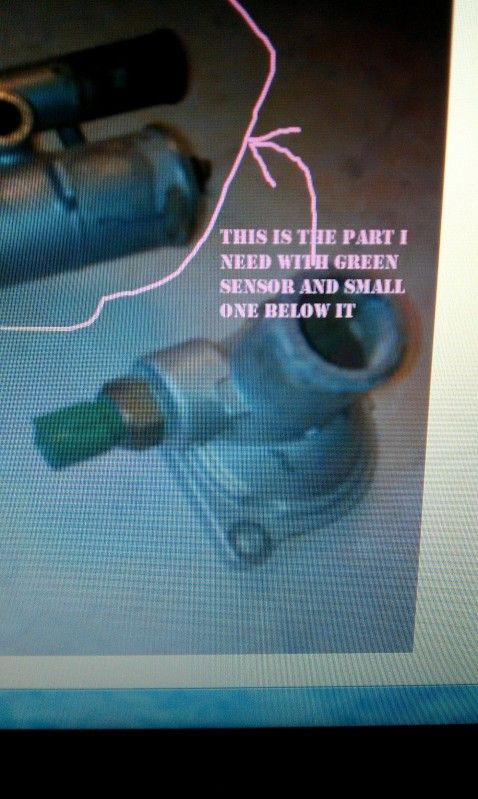

corofin12345 Posted November 7, 2012 Posted November 7, 2012 (edited) see this sensor in yellow circle (dont mind red circle), is your sensor the same? 3 pinwhere the red circle is, thats where the spade connection is for temp gauge on 96/97 water housings... the pic shows a 98/99 water housing.. the 3rd pin in the sensor in yellow circle is for temp gauge Edited November 7, 2012 by corofin12345 Quote
Beastmode panda Posted November 7, 2012 Author Posted November 7, 2012 This is the ONLY bit i took off, just the thermostat housing and un popped the sensor from the bit in the pic below Quote
corofin12345 Posted November 7, 2012 Posted November 7, 2012 yep, nothing to do with temp gauge.. if you can at all, take a pic tomorrow of your water housing and i/we might spot something then Quote
Beastmode panda Posted November 7, 2012 Author Posted November 7, 2012 ok matey will do! cheers Quote
