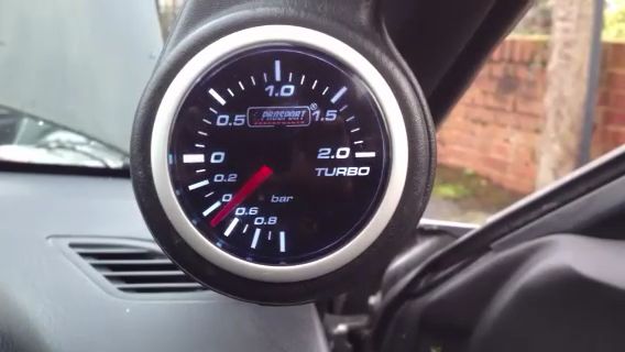

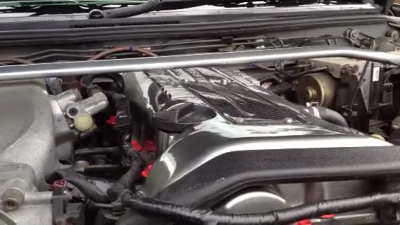

akyakapotter Posted January 16, 2013 Posted January 16, 2013 (edited) Ok anybody no anything about the sr20det engine my mate has an intermittent misfire once warm it's not coil packs or plugs as we have checked them its getting to a point where we don't no what to check next may be a leaky injecter some help would be magic here are a few vids http://i164.photobucket.com/albums/u36/akyakapotter/22ACDB13-F961-4A3D-B39F-2D9BC4967C4A-1758-000001EC15928A1B.mp4http://i164.photobucket.com/albums/u36/akyakapotter/0E05D483-3F3E-429C-ABBA-643B8D6E13CF-1758-000001EE8EA478CE.mp4Thanks in advance guys Edited January 16, 2013 by akyakapotter Quote
