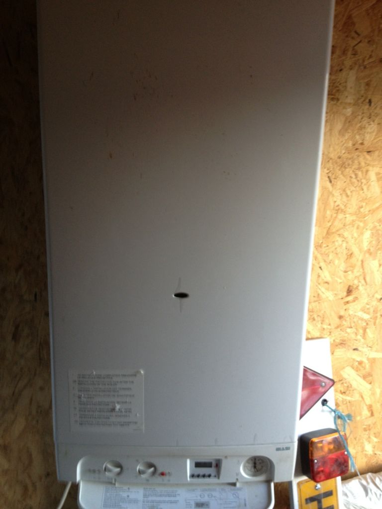

Lew91 Posted February 15, 2013 Author Posted February 15, 2013 Oh right I see what your saying, the flu is angled upwards slightly. It's one of these A biasi, if that means any thing Quote
little dave Posted February 15, 2013 Posted February 15, 2013 That's not one I know but I'm not likInv the fact it's mounted to chip board that's a big no no can you pop the front cover off and take another pic so I can see how the burner sits Quote
Lew91 Posted February 15, 2013 Author Posted February 15, 2013 It's mine shed lol it's mounted to some 4x2 that's screwed to the chip board, it's sturdy enough. I'll grab some pics tomorrow in the light I've tried running the hot water and it doesn't get as hot as it used to, it's more Luke warm, bloody shower was shit! Quote
little dave Posted February 15, 2013 Posted February 15, 2013 Take it off the wood and put plaster board the very Least it's not so flammable then get a pic I may need to talk u through stripping down and doing sum hard core cleaning and can u work out the degree of fall on the flu for me it should be 3 degree anything over is an issue Quote
