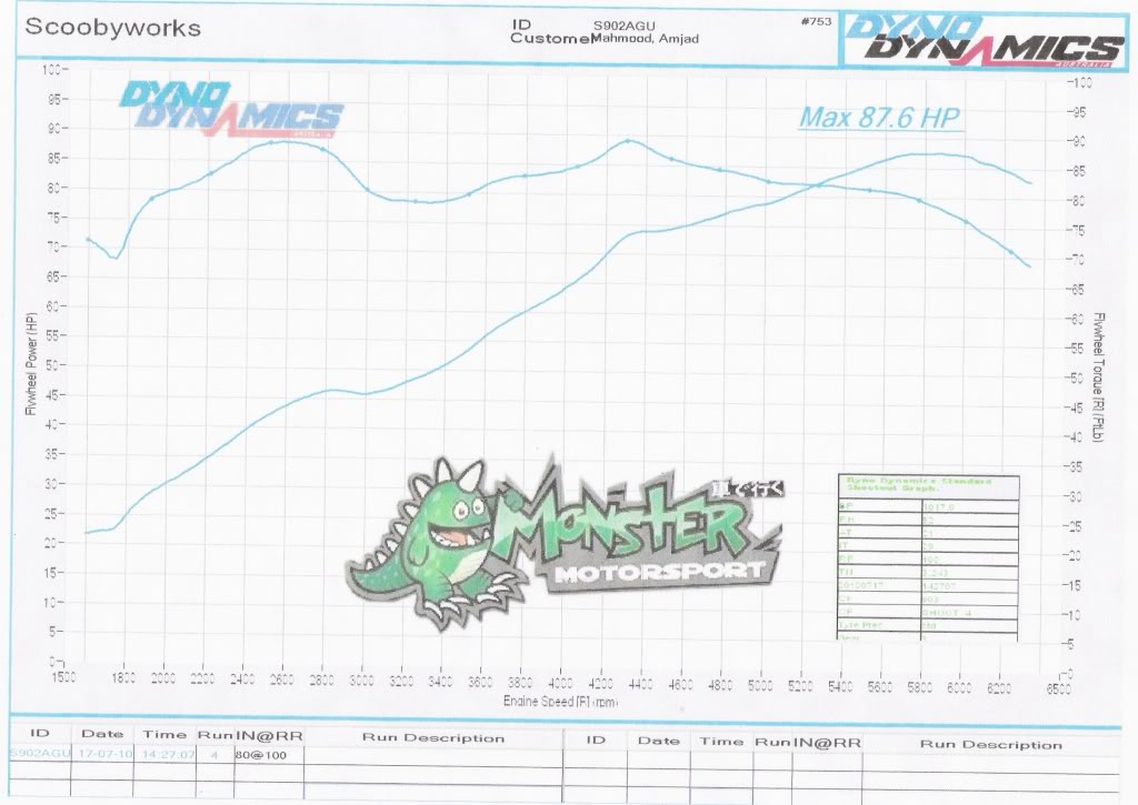

Amjad Posted March 4, 2013 Posted March 4, 2013 I ran 87.6bhp and 89ish torque on a Corolla mani and cat-back, with a cheapo pod filter Switched back to K&N panel and it has heaps more torque, it's a town daily driver friendly setup but still fun when you want it to be. Quote

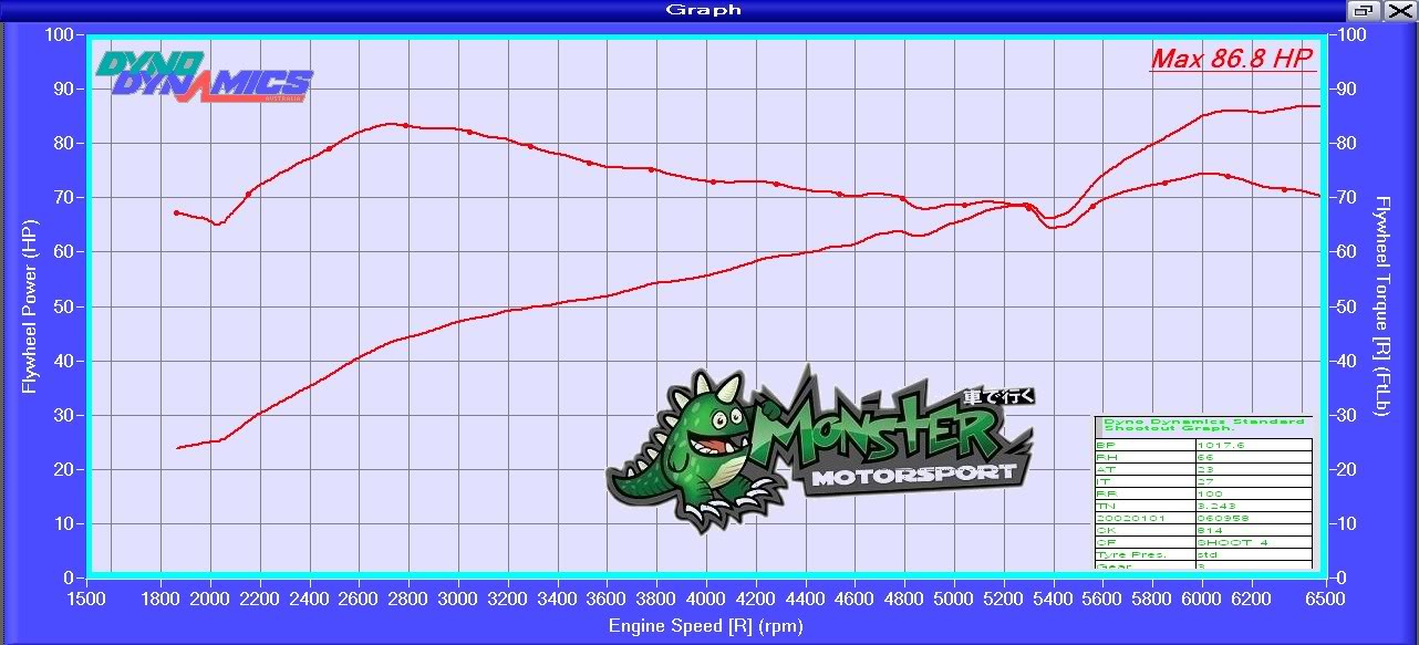

rmsnoel Posted March 9, 2013 Posted March 9, 2013 Can someone post amjads, ryan langs, joels, lee redhead, siren and ryan devonports dynographs from the ultimate ep leaderboard. Quote
rmsnoel Posted March 9, 2013 Posted March 9, 2013 (edited) Ryan devinports- standardamjad and sirens together - corola manifoldRyan lang and joels togethet- glanza manifoldWe can then see corolla gives high smoothish torque curve and glanza gives 15bhp less throughout the rev range until vtech kicks in.Id like to speak to ryan devinport because he made huge power and torque using a standard inlet manifold. Edited March 9, 2013 by rmsnoel Quote
Amjad Posted March 9, 2013 Posted March 9, 2013 It's Ryan5793 (Devonport) that got the high figure My graph is on Sock's leaderboard Quote
rmsnoel Posted March 9, 2013 Posted March 9, 2013 Amjad on a corolla manifold http://www.s314kba.co.uk/leaderboard/images/amjad.jpgRyanLang on glanza manifold http://www.s314kba.co.uk/leaderboard/images/ryanlang.jpg Quote
