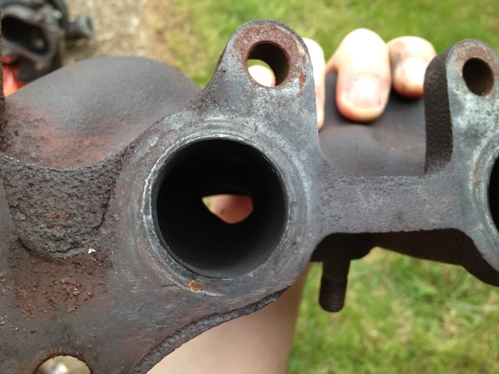

Jim* Posted April 24, 2013 Posted April 24, 2013 Anybody know of a guide anywhere on how to port the standard exhaust? If not can anybody make me one please Quote
akyakapotter Posted April 24, 2013 Posted April 24, 2013 i completely for got to get you pics ill get on it in 5mins if i can find the mani Quote
Jim* Posted April 24, 2013 Author Posted April 24, 2013 i completely for got to get you pics ill get on it in 5mins if i can find the mani thanks mate Quote
akyakapotter Posted April 24, 2013 Posted April 24, 2013 http://s164.photobucket.com/user/akyakapotter/media/null-13.jpg.html'>http://s164.photobucket.com/user/akyakapotter/media/null-12.jpg.html'>http://s164.photobucket.com/user/akyakapotter/media/null-11.jpg.html'>there you go bud Quote

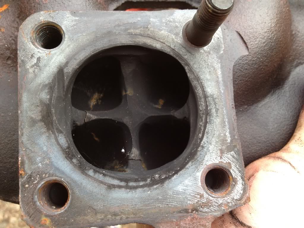

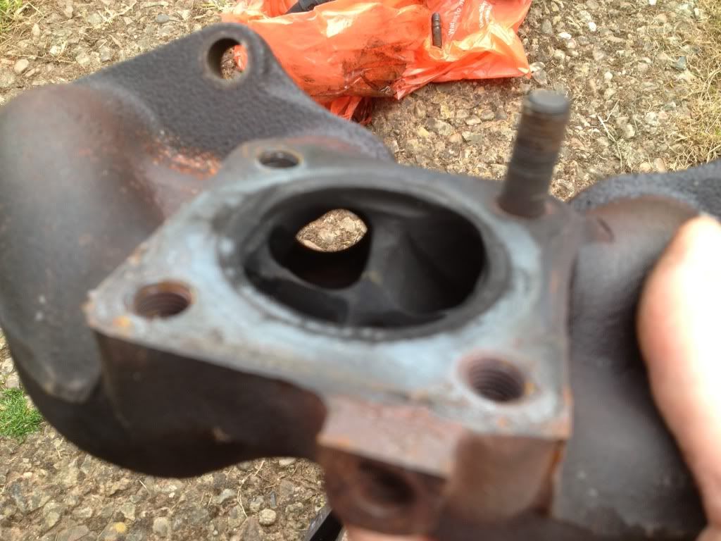

mattglanza79 Posted July 20, 2013 Posted July 20, 2013 What do tou use to port runner three. And silly question but the stud runs into the restriction. What u do about that ? Quote
AdamB Posted July 20, 2013 Posted July 20, 2013 Use a dremel or die grinder to remove the material with something like a carbide burr or a stone, you'll probably chew through quite a few stones though I would expect as they are designed to be used with soft materials like alloys. Quote
mikey4410 Posted July 20, 2013 Posted July 20, 2013 I used stone pieces and went through 2 easily. But worth it Quote
mattglanza79 Posted July 20, 2013 Posted July 20, 2013 What about the turbo mount stud that goes into the restriction Quote
mikey4410 Posted July 20, 2013 Posted July 20, 2013 Thats what you are grinding out.lol.you dont want that there causing the heat buildup Quote
mattglanza79 Posted July 20, 2013 Posted July 20, 2013 So silly question but your only mounting turbo on three studs. Surely that will blow. Will rhis make my boost creep safer as suffering bad Quote
mattglanza79 Posted July 20, 2013 Posted July 20, 2013 Anyone get a really good pic of how much I need to grind away then please Quote
mattglanza79 Posted July 20, 2013 Posted July 20, 2013 So do I grind that restriction away completely? Quote
