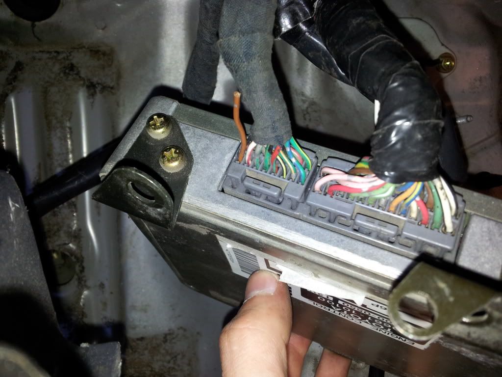

Alright, so i have changed all the looms in my GT because a previous owner had butchered them. But i have just noticed when relocating my ECU that there is a snipped wire which doesn't go anywhere...
Anyone know where its supposed to go ?
Or why this wire would be cut ?
Car starts and runs fine, cant properly test because no MOT etc.
No EML light or any fault codes.
Any help appreciated :) , heres a pic.
According to the wiring diagram, that wire is +B1; Switched battery power (12v) and the one below it in the same plug, does the same thing.
I guess because they do the same thing you only need one of them, but I'm not sure why there is 2 at all if that's the case... :/
Ahh well thats not to bad if thats the case. So it must have been used to power something then. I couldn't find a wiring diagram to check.
One of the lads in work reckoned it was to get round the 180 kph speed limit, but that was just a guess.
