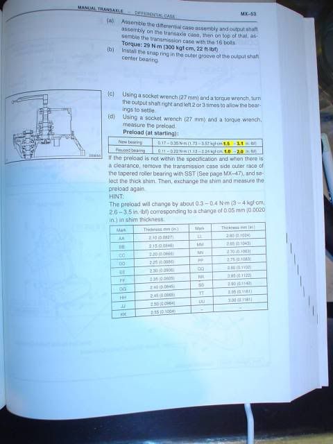

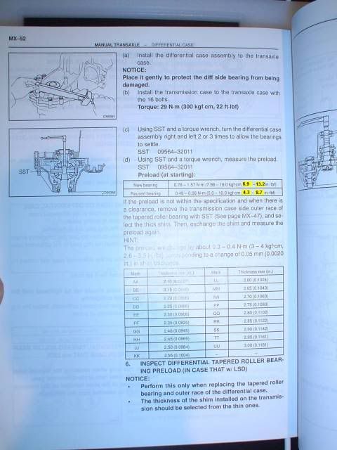

pockrockgtti Posted June 7, 2013 Posted June 7, 2013 You need a dial type torque bar. Basiccally you assemble the box with just the diff and its bearings inside no other gears inside, you torque the gearbox casing together, then with the use of a special adapter which you place throu were the driveshaft goes. You attach the torque bar to the adspter and then you try to rotate the diff and see how much torque it takes to roatate it. Quote
morgey Posted June 7, 2013 Author Posted June 7, 2013 I think you check it with tht blue stuff I was talking about mate this is what I was getting it jus couldnt gather the right names we didnt spend much time on this subject. Torque settings could be more difficult why not contact Mike @ TD or Ricky @ Race Tech im sure they will hav fitted a few?Might be a good idea! You need a dial type torque bar. Basiccally you assemble the box with just the diff and its bearings inside no other gears inside, you torque the gearbox casing together, then with the use of a special adapter which you place throu were the driveshaft goes. You attach the torque bar to the adspter and then you try to rotate the diff and see how much torque it takes to roatate it.Ahh i see, i can see some spare driveshaft cups coming out and some claw type oil filter removers Quote
pockrockgtti Posted June 7, 2013 Posted June 7, 2013 You do it like this for standard open diffAnd like this for aftermarket lsdThese are taken from sn mr2 spyder manual, preload figures may be diffrent, procedure will be same. Quote
