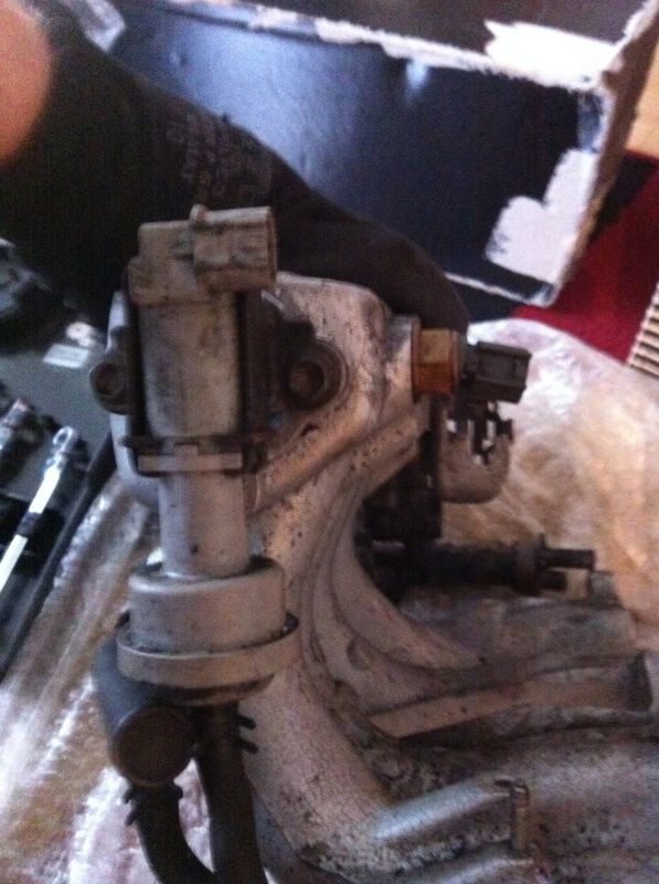

starletgt-shady Posted June 18, 2013 Posted June 18, 2013 what is this on the side of the intake manifold and what does it do? do I need It?thanks for any help Quote
starletgt-shady Posted June 18, 2013 Author Posted June 18, 2013 Do I need this if I have a sard rrfpr. Can I get rid of it ? Quote
Lew91 Posted June 18, 2013 Posted June 18, 2013 Idle control valve isn't it? http://www.toyotagtturbo.com/forums/showthread.php?57564-Idle-Control-Valve-Removal-and-cleaning Quote
starletgt-shady Posted June 18, 2013 Author Posted June 18, 2013 How would I use this on an uprated manifold as there ain't a place for it go? Quote
iamlegend Posted June 18, 2013 Posted June 18, 2013 lol... idle control valve indeed... will make a ticking noise.. give it a clean Quote
starletgt-shady Posted June 19, 2013 Author Posted June 19, 2013 Anyone? I have a zisco uprated manifold and just want to know how I use the icv with it? Quote
Lew91 Posted June 19, 2013 Posted June 19, 2013 Isn't it not needed? I thought you can just control the idle with the TB. Quote
DevonGT Posted June 19, 2013 Posted June 19, 2013 Anyone? I have a zisco uprated manifold and just want to know how I use the icv with it? You can't, unless you make up your own bracket. There's a screw you can use to adjust the idle if need be on the TB I think. Quote

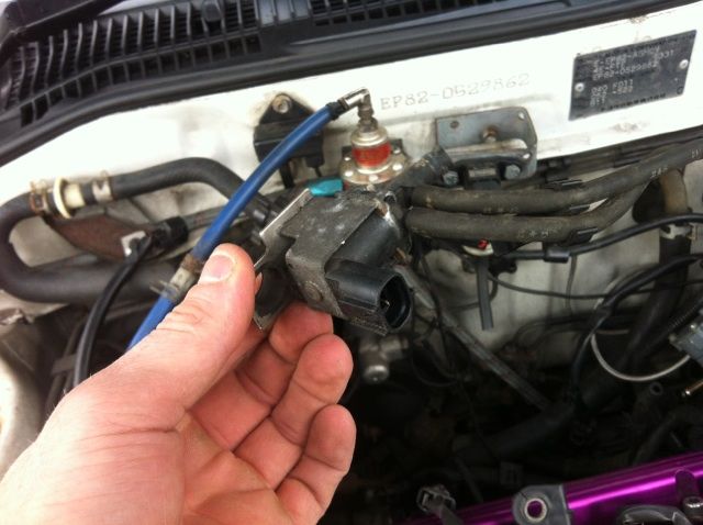

starletgt-shady Posted June 20, 2013 Author Posted June 20, 2013 anyone know what this is? is it needed?any help be great trying to get things tidied up and fit new manifold http://s1290.photobucket.com/user/starletgtshady/media/Mobile%20Uploads/IMG_2800_zps43cb0d89.jpg.html'>http://s1290.photobucket.com/user/starletgtshady/media/Mobile%20Uploads/IMG_6125_zps44bedffe.jpg.html'> Quote
starletgt-shady Posted June 20, 2013 Author Posted June 20, 2013 I'm guessing its not really needed? Any ideas what it is? I Got rid of the air con bits. Quote
Lew91 Posted June 20, 2013 Posted June 20, 2013 Boost solenoid, I cut the plugs off for the air con as well and taped them up. Charcoal canister can go as well and if your willing get an inline fuel filter and get rid of the big ugly one on the firewall. Quote

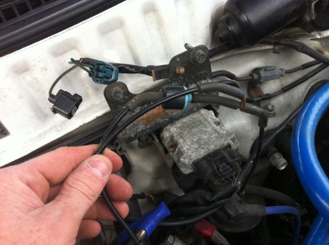

starletgt-shady Posted June 20, 2013 Author Posted June 20, 2013 Ok cheers that's great. Is that the one with the thin vacuum lines going to it. Most of the lines going to the throttle body can get blanked of then?? Quote
Lew91 Posted June 20, 2013 Posted June 20, 2013 (edited) Yeah that's the one, there will be a hard line going to it from under the car as well you'll want to put a uni flow valve on that, there about a fiver off eBay. Yes plug all the ones coming off the TB and it should'nt affect the idle. Edited June 20, 2013 by Lew91 Quote
