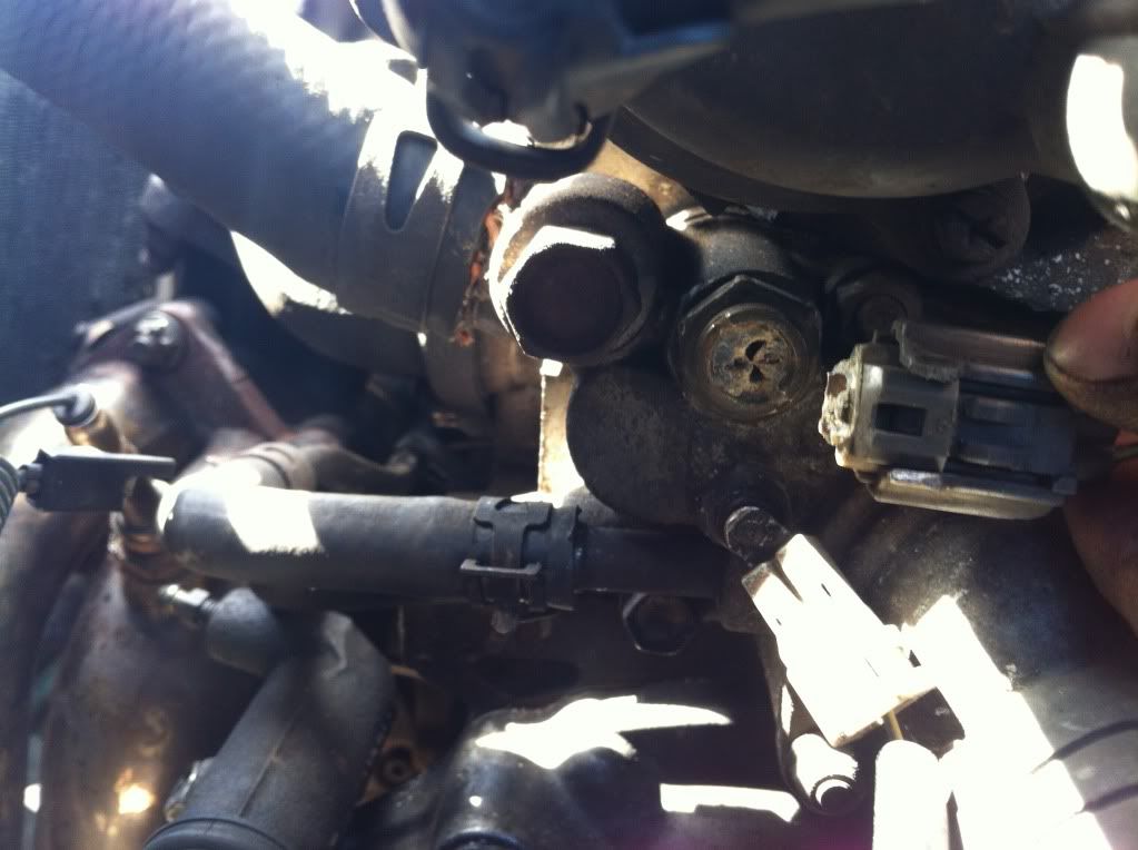

weddy1988 Posted June 19, 2013 Posted June 19, 2013 hi all jsut put my gearbox in and new manifold ect flushed the oil and new oilman problem is the thermostat isnt opening...the top pipe is'nt going hard and wont allow water into the radi snapped this sensor but im woundering this cant be the coolant temp sensor because the temp gauge is working...is this why the thermostat aint opening...i thought thermostats worked with wax and it opened via heat??here the snesor 19mm thing when pulled out has a little bronze thing that pokes into the engine 2 wire afair http://s252.photobucket.com/user/weddy1988/media/null_zps8cdf467d.jpg.html'>car keeps heating up fan kicks in but not enough to cool the car ...like sed top hoose isnt hard no water running through Quote
weddy1988 Posted June 19, 2013 Author Posted June 19, 2013 actually it does look liek its a coolant tempt sensor, but my car still is showing the temp on the gauge? Quote
AdamB Posted June 19, 2013 Posted June 19, 2013 If the thermostat isn't opening then thats your problem. The temp gauge will still work as it takes the feed from a single wire spade connection on the housing Quote

weddy1988 Posted June 20, 2013 Author Posted June 20, 2013 got a new coolant temp sensor off an MR2 fits a beut...so eml is out now...bled the system again no over heating cools a little treat....thr blower for the fans dont work though as ive jsut noticed on hot or cold no fans atall anyone know the fuse number and were the location of the fusebox is bloody driveshaft oil seal is leaking on the drivers side also so going to check if shaft is in properly , apart from that its built and running well idling at around 750RPM ...slight hiccups on idle i'm guessing this is normal maybe a hiccup every minute or so just a light miss it sounds like Quote
Socks Posted June 20, 2013 Posted June 20, 2013 Thermostat is mechnical... Opens when the water is at the temp its designed for... There not expensive put a new one in, its not worth messing about... EP's have 2 sensors 1 for the gauge and 1 for the ECU. Chances are the one of the ECU was the one u broke... Quote
