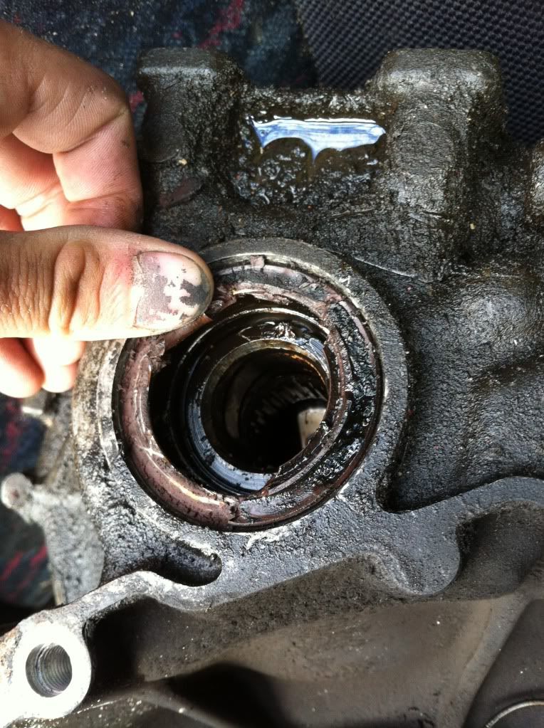

weddy1988 Posted June 21, 2013 Author Posted June 21, 2013 i should have listend haha , everyone is going on about levers and pick axe's , there jsut silly wee bits of rubber arent they lol :|? this is the state of mines after trying to pick it outhttp://s252.photobucket.com/user/weddy1988/media/null_zpsef34ce52.jpg.html'>http://s252.photobucket.com/user/weddy1988/media/null_zpsd40344a1.jpg.html'>its liek there almost superglued in place on my old box lol Quote
daniel_g Posted June 21, 2013 Posted June 21, 2013 You need to get in behind that bit and pop it out. Theyres a fair bit of metal in them too, the NS one is a bit harder to do than the OS one i found, because it goes in a bit deeper i think. Theyre right wedged in man haha. Quote
weddy1988 Posted June 21, 2013 Author Posted June 21, 2013 so there not all rubber theres metal ?, so its more than likely then metal i'm down to when scraping the rubber off...so put the pry bar on the inside of the box and pry them out rather than going from the outside trying to put up the lip ? Quote
daniel_g Posted June 21, 2013 Posted June 21, 2013 Yeah thats right. Id say its about 10mm deep you need to go. If you get a pry bar just on the inner lip and pry against the box. It should pop out then. Or wait till your new one comes so you know what youre up against lol. Quote
StuDoc 72 Posted June 22, 2013 Posted June 22, 2013 Jus stick a plain screwdriver behind that pink bit and pry it out mate. Quote
