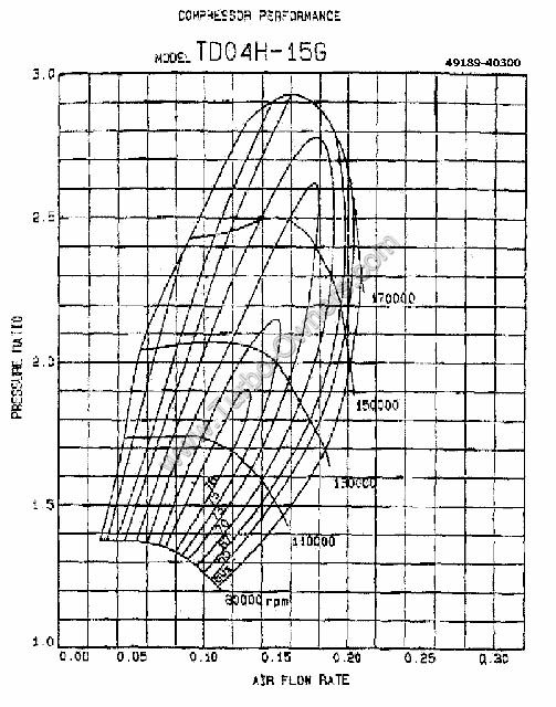

Glanza-Ben Posted October 14, 2013 Author Posted October 14, 2013 15g is the norm td04 turbo. PhilSo this is just a bigger version, what do you think spool etc will be like Quote

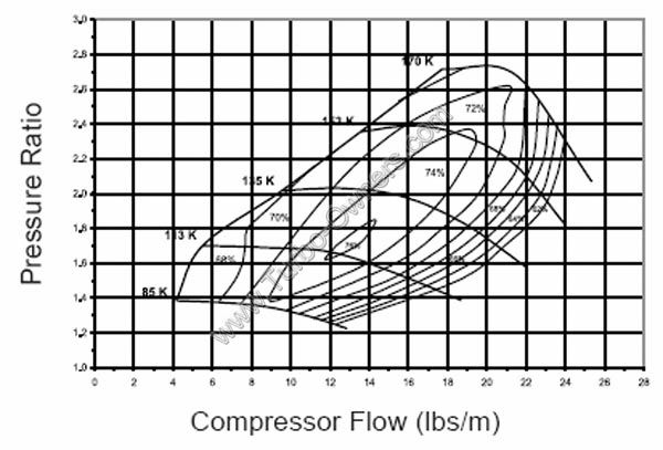

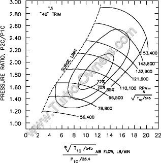

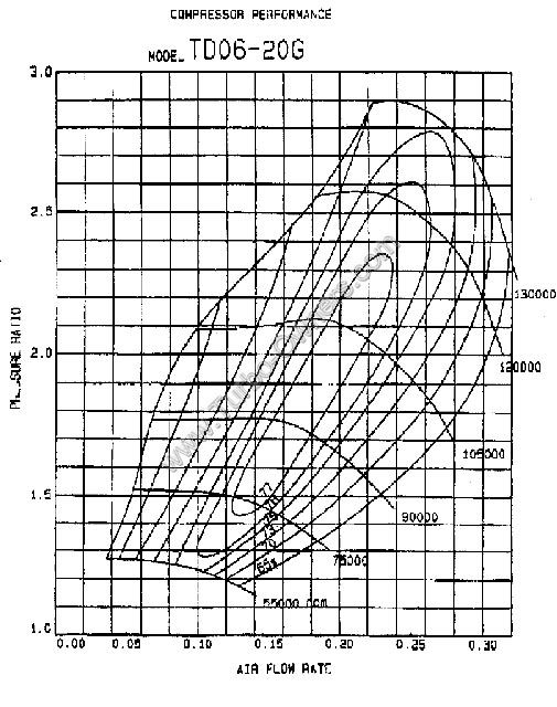

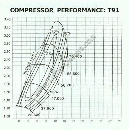

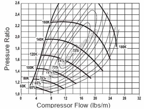

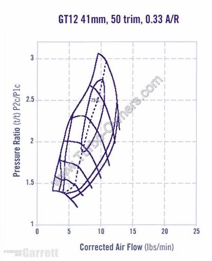

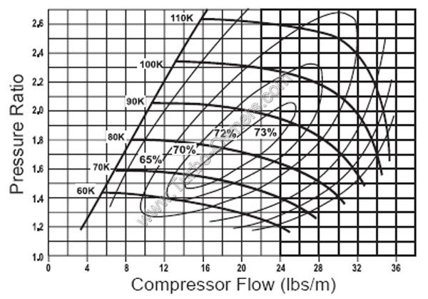

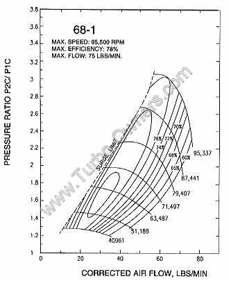

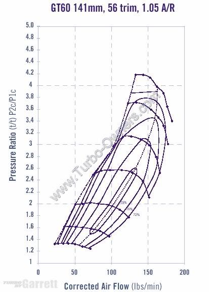

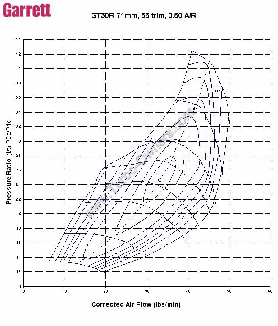

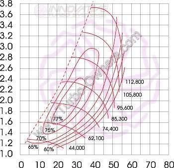

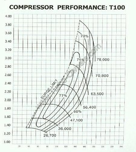

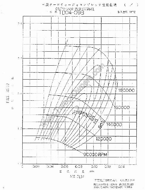

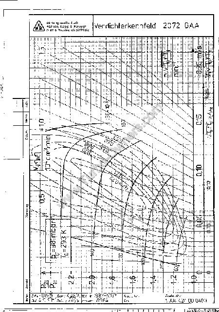

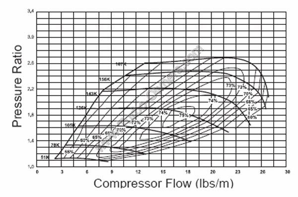

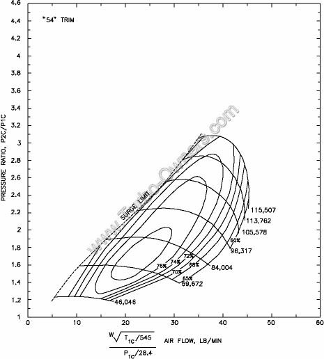

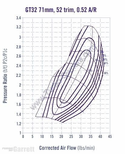

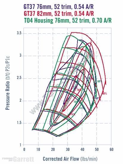

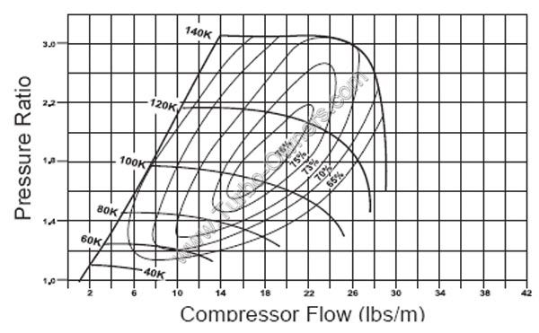

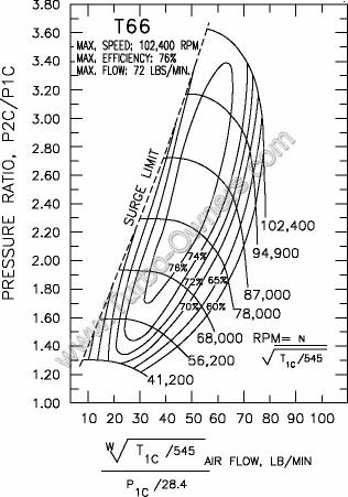

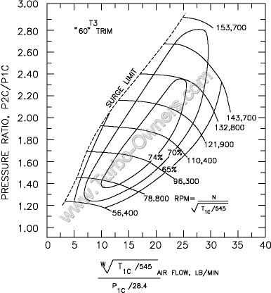

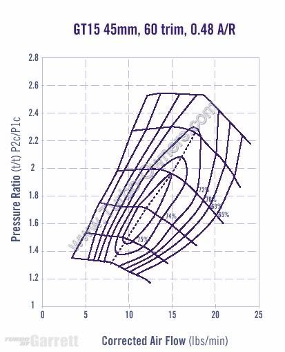

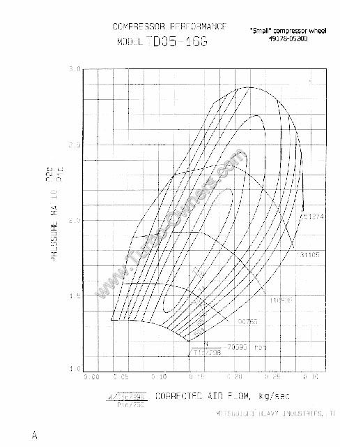

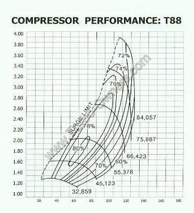

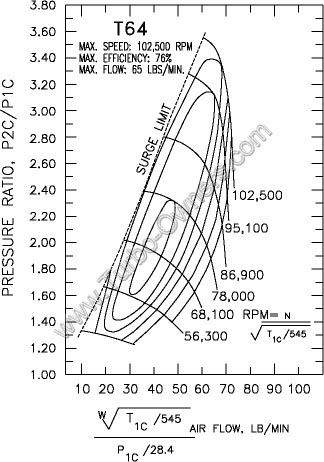

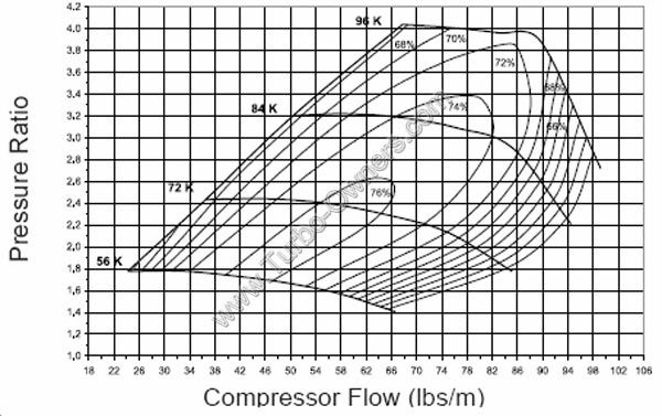

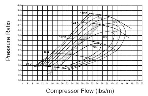

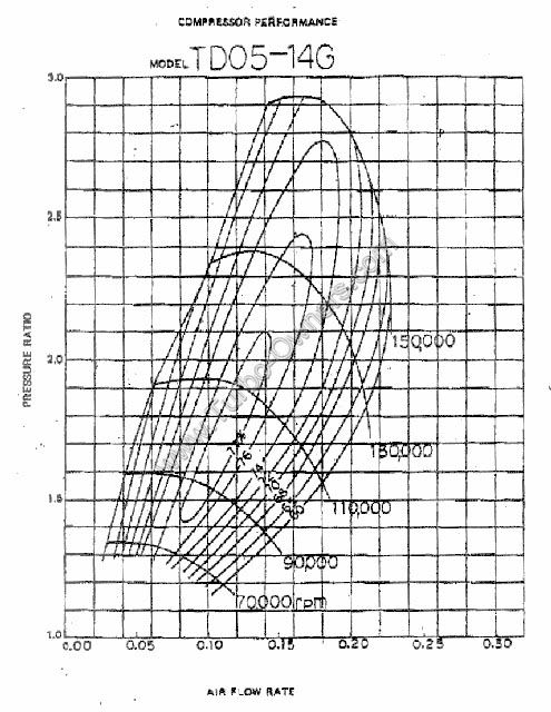

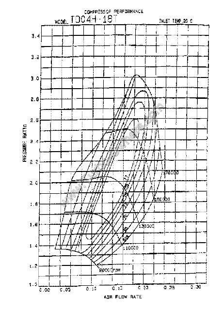

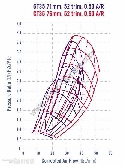

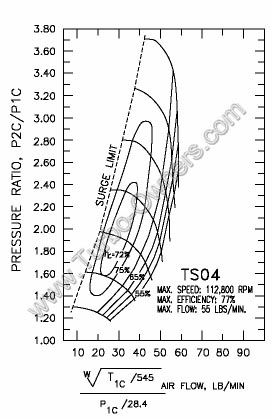

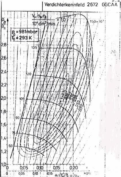

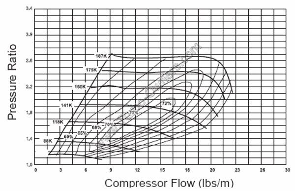

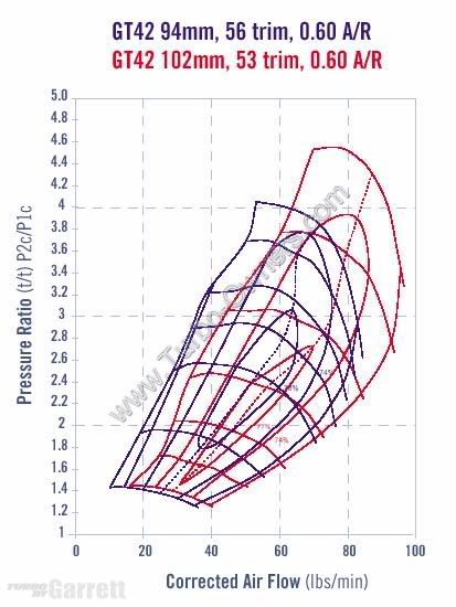

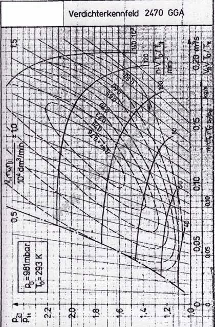

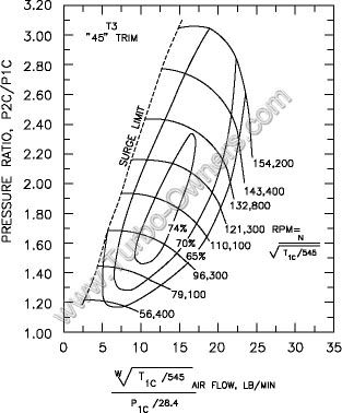

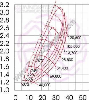

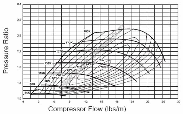

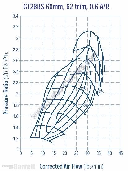

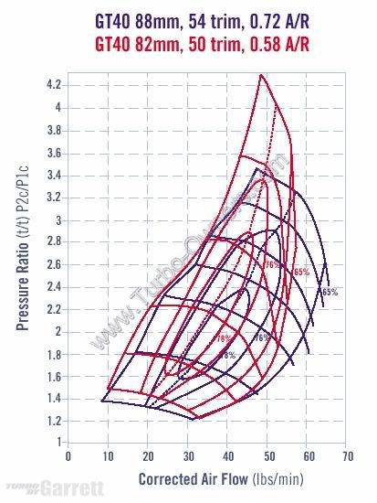

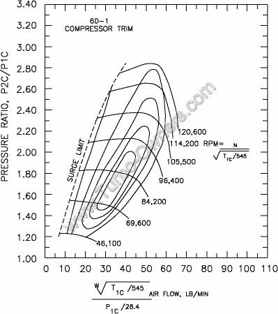

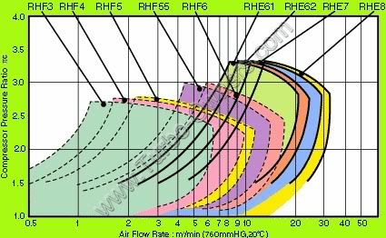

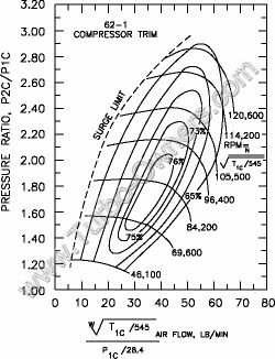

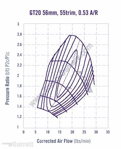

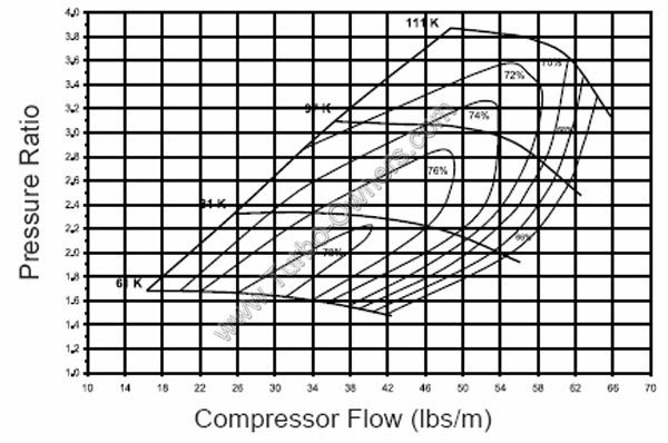

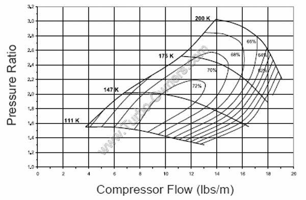

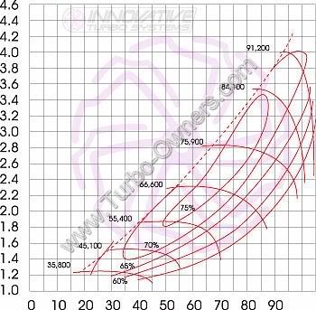

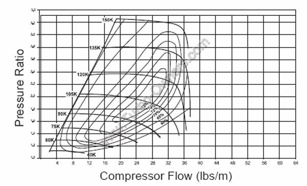

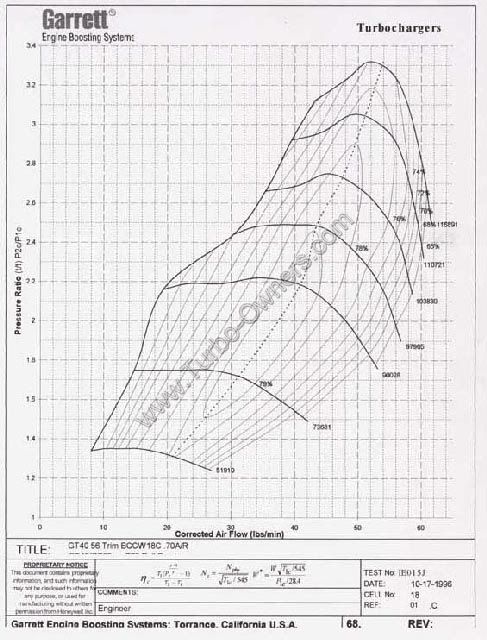

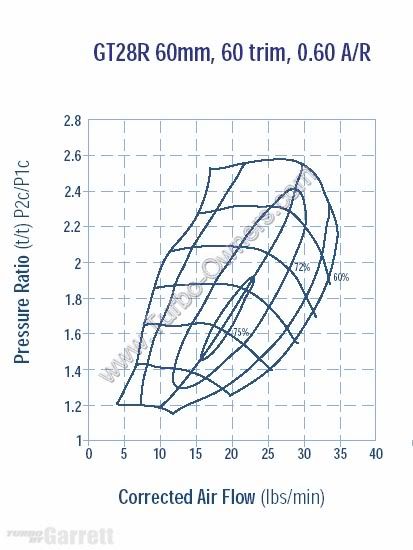

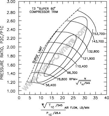

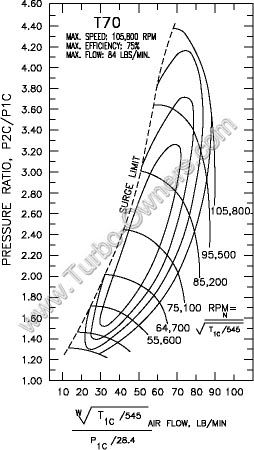

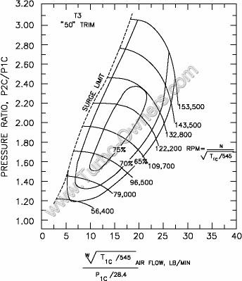

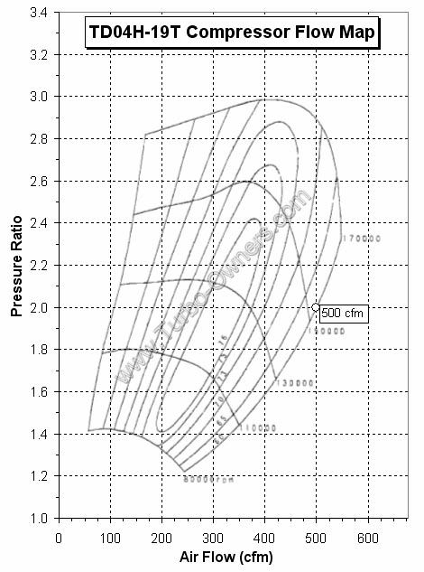

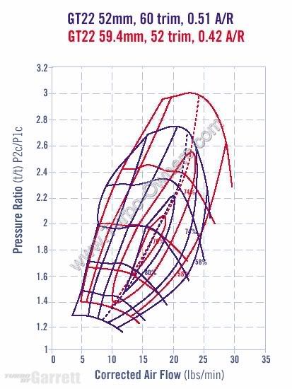

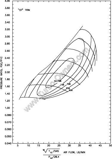

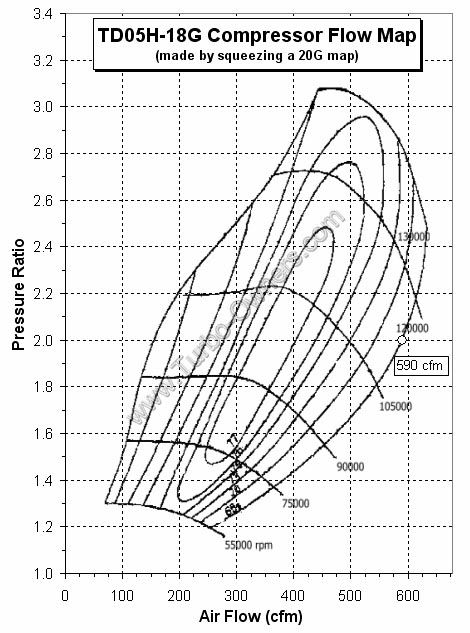

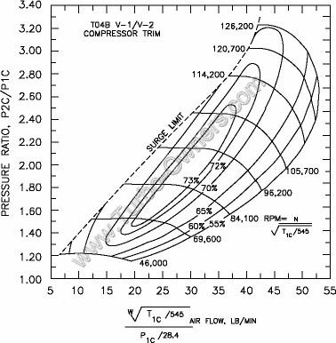

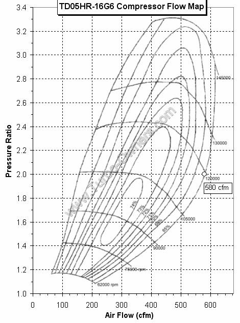

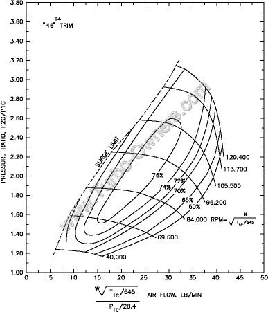

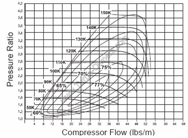

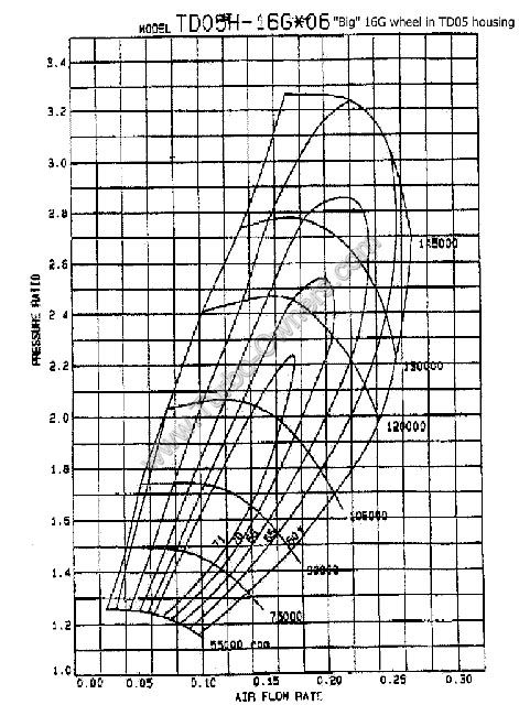

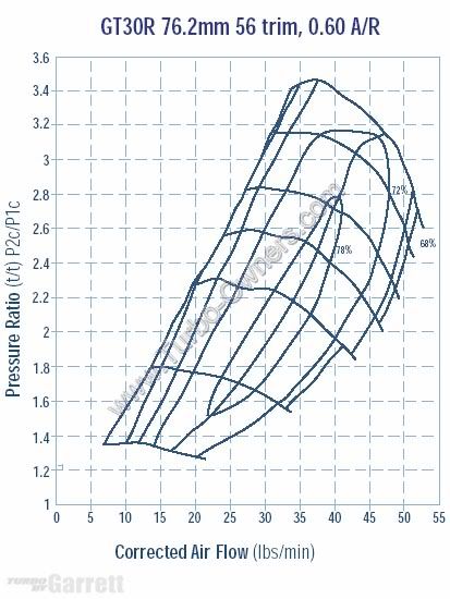

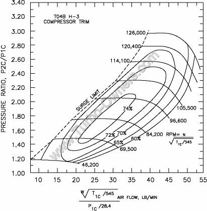

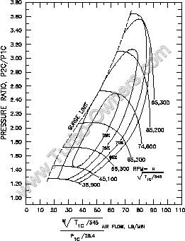

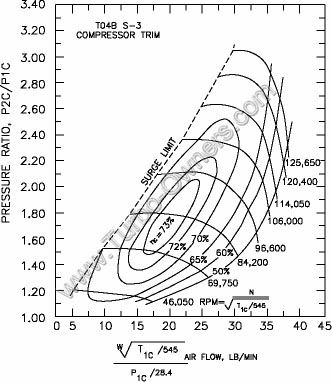

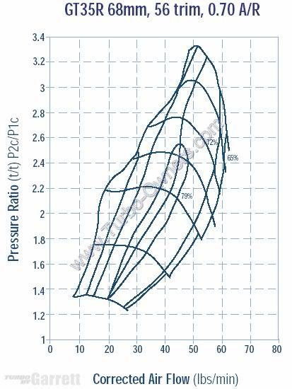

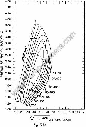

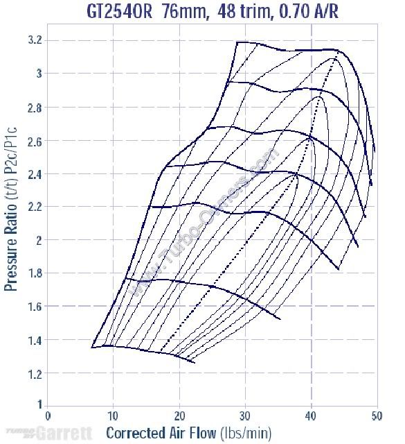

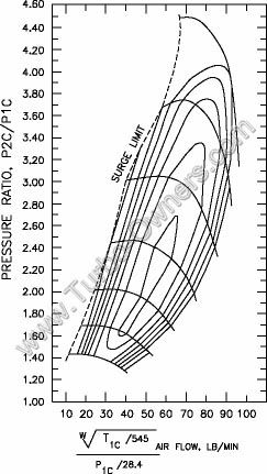

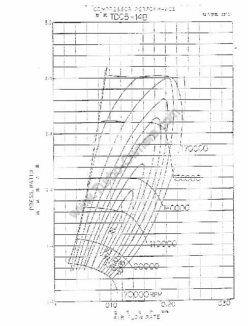

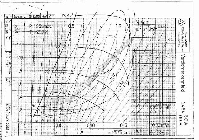

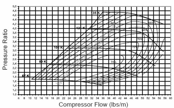

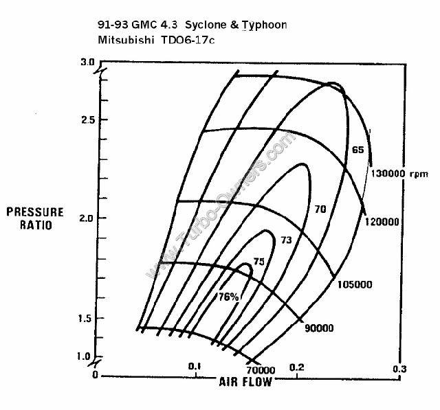

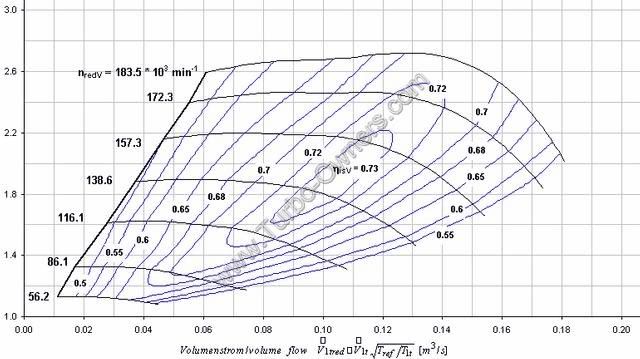

Phil Posted October 14, 2013 Posted October 14, 2013 (edited) oh i cant remember what i used to know about td04s...blast pretty sure the XXg or XXb orXXt is the exhaust side so i would assume bigger number is bumper housing. ill try and find the thread, . Phil EDIT BOOM boom shake the room http://www.toyotagtturbo.com/forums/showthread.php?25207-turbo-size-s GT12GT15GT20GT22GT2540RGT25RGT28RGT28RSGT3071RGT30RGT32GT35GT35RGT37GT40-56trimGT40GT42GT60IHI MapsK03-2072K03-2075K03-2072K04-0025K04-2075K04-2275K14-2464K16-2467K24-70GGAK26-2K26K27RS2-2672S1bS1BGS200S2BS300S400S510T-100T-58T-61T-64T-66T-68-1T-70T-72T-76T-80T-88T-91T04B-60-1T04B-62-1T04B-H3T04B-S3T04B-V1-V2T04E-42trimT04E-42trimT04E-46trimT04E-50trimT04E-54trimT04E-57trimT04E-60trimT3-45trimT3-50trimT3-60trimT3-Super60trimTD04-09BTD04-13GTD04-15GTD04H-16T-CFMTD04H-18TTD04H-19T-CFMTD05-14BTD05-14GTD05-BIG-16GTD05-SMALL-16GTD05H-18G-CFMTD05HR-16G6-CFMTD06-17CTD06-10G-2TD06-20GTS04 Courtesy of Texx (Tgtt) Edited October 14, 2013 by Philm Quote
