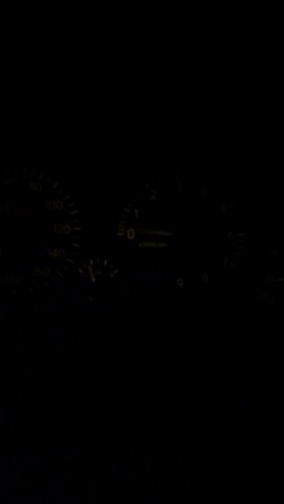

GrantEP82 Posted January 11, 2014 Author Posted January 11, 2014 Here is the first vid, you can see when I put my foot down in second it just stays there at 2k Quote

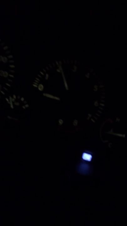

GrantEP82 Posted January 11, 2014 Author Posted January 11, 2014 This is the other one, turned the car on, gave it a little rev then the revs dropped and it stalled?? Quote
