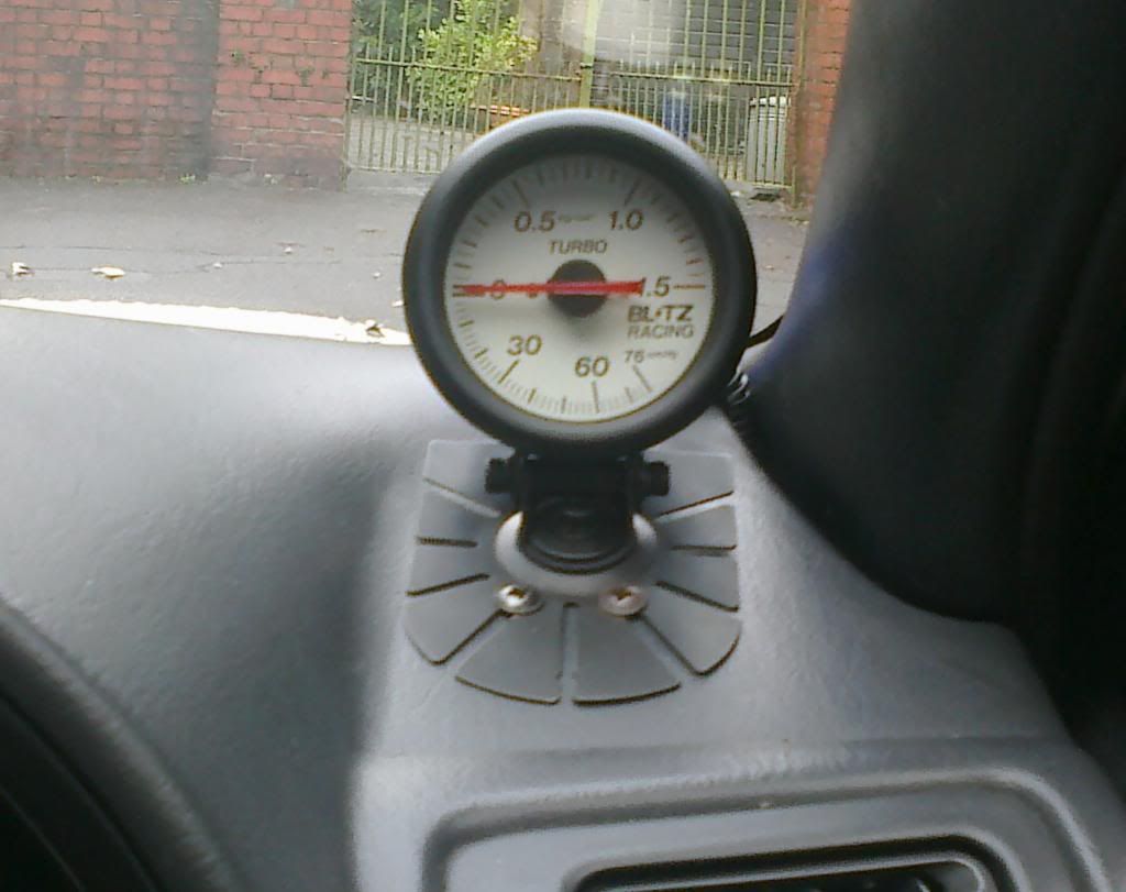

Lol Just finished fitting one not too difficult drill a hole in the bulkhead unless you can utilize one that's already there run the vacuum pipe through and into the pipe that runs off the inlet to the bov with the wiring there are diagrams on here somewhere if u search i run the live through the ignition as i couldn't get a strong enough feed from the sidelights to power the light in the gauge doesn't look quite as good as phil's though love the cardboard effect.
