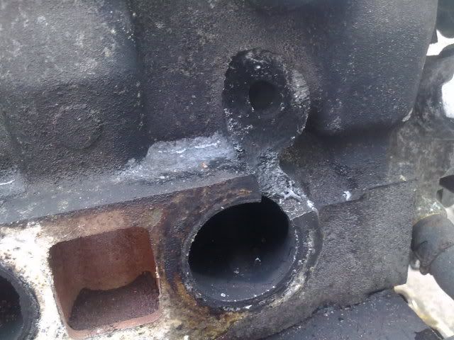

jimmymac101 Posted March 30, 2014 Posted March 30, 2014 That's a common problem with glanza heads mate, nothing out the ordinary there James Quote
leemillin Posted March 30, 2014 Author Posted March 30, 2014 what do i need to apart from a head? Quote
Jap91 Posted March 30, 2014 Posted March 30, 2014 Did u crack the head trying to take off the mani Quote
leemillin Posted March 30, 2014 Author Posted March 30, 2014 i didnt do it myself, a garage done it but there saying it was already there Quote
StarletSr? Posted March 30, 2014 Posted March 30, 2014 i didnt do it myself, a garage done it but there saying it was already thereIf it was already there why did they still try to remove it surely they would contact you about it?It can be weld dont no how long it would last or you could get the head swapped but that may cost a bit with the gasket and headbolts Quote
leemillin Posted March 30, 2014 Author Posted March 30, 2014 Think i'll just get another head as i want it to last. What parts do i need to get? Quote
bucketep91 Posted March 30, 2014 Posted March 30, 2014 Cant really blame the garage for that! Quite common on all 4eftes not just glanzas (as someone else said) i had one crack on a gt in the exact same place. When you remove the manifold a whole chunk will come off. Quote
leemillin Posted March 30, 2014 Author Posted March 30, 2014 my block was all good till it come out of the garage who fitted a manifold for me Quote
leemillin Posted March 30, 2014 Author Posted March 30, 2014 by the sound of it, but there saying they didnt do it :/ Quote
bucketep91 Posted March 30, 2014 Posted March 30, 2014 Mine snapped off when removing the oem manifold( without excessive force) as i said its a weakspot/common fault. Always seems to be the the exact same place too. I bet my chunk would fit in your hole ;)) Quote
