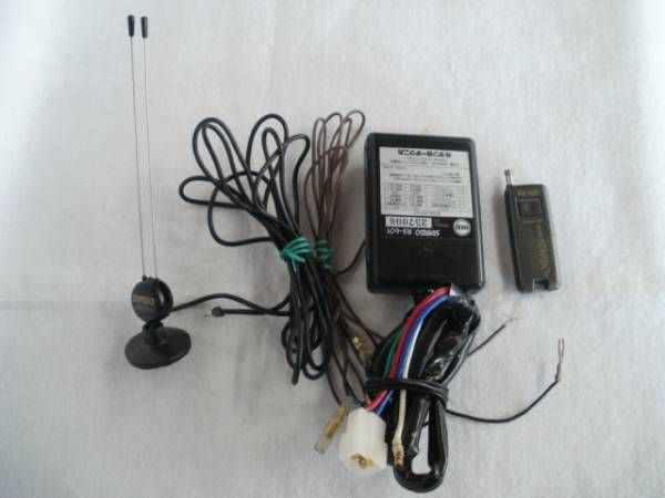

JLF88 Posted February 11, 2014 Posted February 11, 2014 Turbo timer. Should have numbers 1-6 on and off. Quote
akyakapotter Posted February 11, 2014 Posted February 11, 2014 (edited) turbo timer 100% Edited February 11, 2014 by akyakapotter Quote
dangeestarlet Posted February 11, 2014 Posted February 11, 2014 It's a turbo timer and remote engine start Quote
JLF88 Posted February 11, 2014 Posted February 11, 2014 Some info I found for youThat STARBO made by SANTECA is an old remote engine starter. MODE SWITCH NO. MODE O N O F F 1 - Park-Neutral automatic detector reset on off(automatic detecting) This should be OFF(detector function-ON) for safety usually.2 - body hood/bonnet open unwiring wiring(You might need to prepare some additional kit for this function)(for counter measure against theft?) 3 - door open switch unwiring wiring(for counter measure against theft?) 4 - automatic stop timer 30 minutes 15 minutes(Usually within 15 minutes would be enough to hold) 5 - turbo timer ON OFF(If not turbo engine, you keep it OFF) 6 - glow time ON OFF(If Diesel engine, you need to go ON)The piano switch aside pushed down would be meant to be ONAll mode are set to OFF ex factory and please read the manual to know how to handle it more precisely.Warning: Avoid trying to switch on the engine on public road for safety.SANTECA Co. LTD. Quote
Rosso321 Posted February 11, 2014 Author Posted February 11, 2014 Aw cool thanks lads so worth anything. ? I've no fob for it tho. Quote
JLF88 Posted February 11, 2014 Posted February 11, 2014 Probably around £15-20 as a turbo timer Quote
