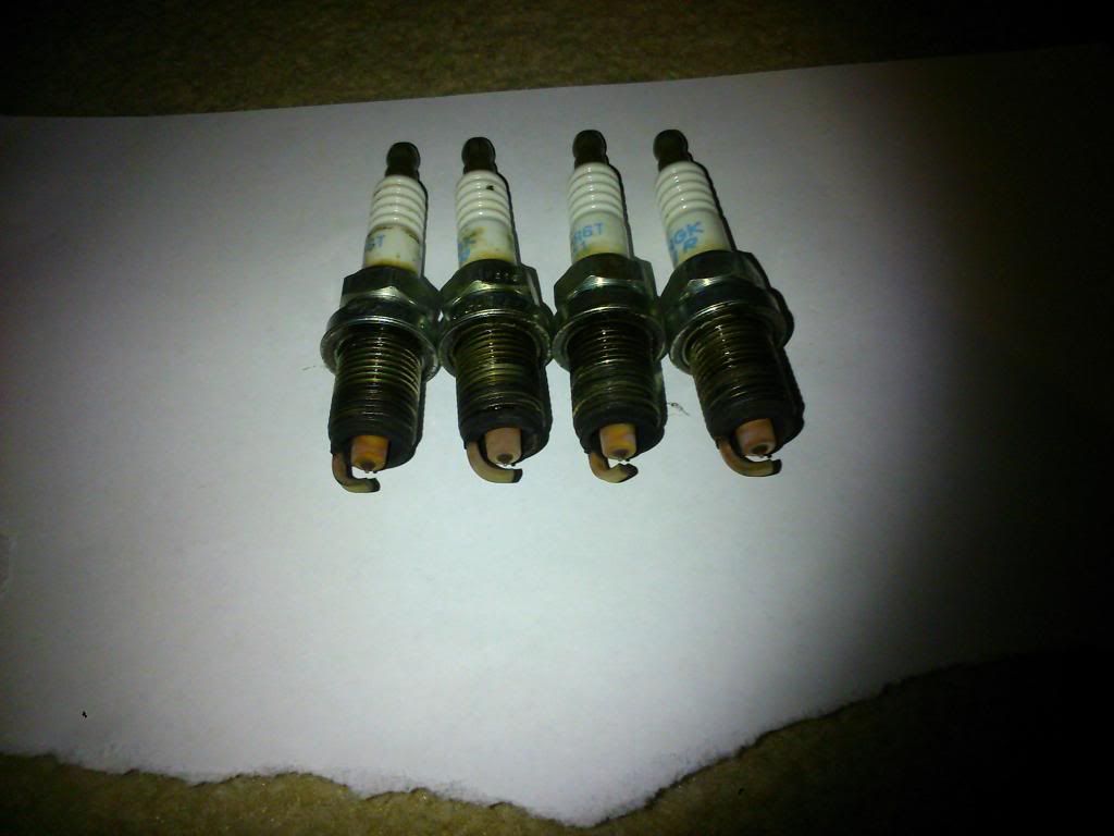

Turbo Goose Posted March 4, 2014 Posted March 4, 2014 (edited) Hi guys, im currently experiencing problems with a missfire. Car judders sometimes at low speeds accelerating until it hits boost, then boosts ok til about 5k then splutters and judders, you can feel it and hear it, if you run it at 3/4 throttle it solves the problem. I am currently running 0.85 bar with a fcd and rrfpr at 3bar (to 3.5 bar atmospheric pressure) I have just put brand new iridium heat range 7's in and the problems still there Here are my pictures of my old plugs if these tell you anything?(The porcelain on the far right plug is red compared to the rest? Its the left one in the bottom pic) Thanks in advance guysDan Edited March 4, 2014 by Haresign Quote
GP82 Posted March 5, 2014 Posted March 5, 2014 Well i think the colour of the plugs look okay from here, maybe a little red or maybe it's jus' the picture, but they would need a closer inspection. Have you used like an injector cleaner or octane booster recently? I would start looking over the ignition system; rotor arm, dizzy cap, leads inc. king, coil. Could poss also be fuel cut depending on how the fcd is setup so you would need to confirm this, maybe check diagnostics for a fuel cut code. Quote

Zeldoz Posted March 5, 2014 Posted March 5, 2014 I replaced mine at the weekend they were in a worse state... Quote
Dean_mc88 Posted March 5, 2014 Posted March 5, 2014 I took mine out after runnin 0.8 with stock ecu no fcd and mine were 100 times worse cleaned them up put them back in with jam ecu runs fine Quote
