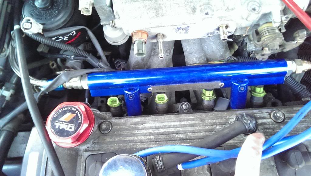

karl. Posted May 12, 2014 Posted May 12, 2014 Is it possible to rotate a injector 180 degrees or is there a spray pattern etc?The ones I have are the same as these I want to rotate them like this like the two on the right Quote
daniel_g Posted May 12, 2014 Posted May 12, 2014 Yeah you can rotate them, keeps the wiring neater. Quote
karl. Posted May 12, 2014 Author Posted May 12, 2014 Yeah you can rotate them, keeps the wiring neater.Exactly the answer I wanted,Thank you Quote

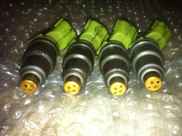

mech5107 Posted May 12, 2014 Posted May 12, 2014 (edited) There are some injectors that the spray pattern is offseted to the injectors. Usually it's easy to tell as the nozzle look crooked...Yours should be fine I would say..What are those from? Edited May 12, 2014 by mech5107 Quote
karl. Posted May 12, 2014 Author Posted May 12, 2014 Maybe I should take them out to get a look to make sure?http://www.ukstarletowners.com/topic/79725-uprated-370cc-injectors-direct-fit/?fromsearch=1They are the same as these. Pretty handy since they are direct fit Quote
