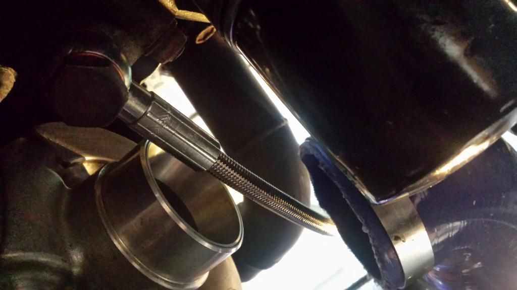

Turbo Goose Posted August 28, 2014 Posted August 28, 2014 Hi guys, my oil feed failed so i bought one off id workz and its just 2 bango fittings on each end of the line so goes straight across the front of the turbo so the air filter hose has no chance of going on. Any ideas? Quote
Matt1878 Posted August 28, 2014 Posted August 28, 2014 Mesh the turbo housing and loose the filter setup Quote
Ollieh17 Posted August 28, 2014 Posted August 28, 2014 Loosen the bolt and twist it in a position where the airfilter doesnt foul. It is possible Quote
Turbo Goose Posted August 28, 2014 Author Posted August 28, 2014 Right so ive managed to squeeze it between the filter and silicone hose just, not entirely happy with how they fit. Surely all these premade td04 oil feeds should have a straight connector instead of a banjo on the m14 side to avoid this. Quote
Idrees Posted August 28, 2014 Posted August 28, 2014 That's how most suppliers have them made and they fit perfectly if you rotate it to the correct position. I've fitted several myself without issues, and we've sold dozens now! Is yours going up behind the turbo or in front? Quote
Turbo Goose Posted August 28, 2014 Author Posted August 28, 2014 Goes infront of the turbo, should it go behind? Quote
Idrees Posted August 28, 2014 Posted August 28, 2014 Yes mate, I've always fitted them from behind. Quote
TurboTobz Posted August 28, 2014 Posted August 28, 2014 My tuning developments one fitted fine with a larger td05 'top entry' (with the huge intake elbow) Suppose it depends on your rotation and the manifold set up. Quote
