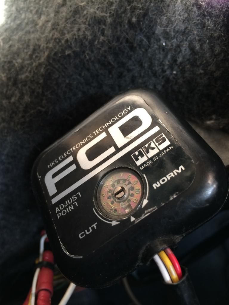

Glanzacoley Posted September 8, 2014 Posted September 8, 2014 Can someone explain how this turny thing works please haah Quote
Glanzacoley Posted September 8, 2014 Author Posted September 8, 2014 I'm taking it off then haha Quote
russ78 Posted September 8, 2014 Posted September 8, 2014 turn boost down to 0.8bar and remove the fcd (fuel cut defender) buddy there just not worth using Quote
Krissyb Posted September 8, 2014 Posted September 8, 2014 it blows up engines buddy ^^^^^^^^^^^^^^^ as above Quote
Glanzacoley Posted September 9, 2014 Author Posted September 9, 2014 How would I remove it guys? Just cut it off or? Quote
Duduglanza Posted September 9, 2014 Posted September 9, 2014 Off course it will NOT blow up the engine! Its not the best way but with the right tuning its fine. I ran one for 5 years and never blew up any engine .If you want to remove it just solder the green wire (attached with the white and yellow) again. Quote
Krissyb Posted September 9, 2014 Posted September 9, 2014 Off course it will NOT blow up the engine! Its not the best way but with the right tuning its fine. I ran one for 5 years and never blew up any engine .If you want to remove it just solder the green wire (attached with the white and yellow) again. With the right tuning, he's been driving it with supporting mods @ over a bar of boost with no tune, funnily enough spun a bearing. Quote
