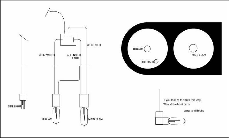

Stu Posted November 26, 2014 Posted November 26, 2014 You can mod the headlight loom to work pretty easily

Stu Posted November 26, 2014 Posted November 26, 2014 You didn't say anything about wires missing. The head light wiring runs across from the driver side to the fuse box. At worst you would need to cut the wires back and start again? If you follow the wire colours its not hard to wire up. Good luck anyway
Glanza-Ben Posted November 26, 2014 Author Posted November 26, 2014 You didn't say anything about wires missing. The head light wiring runs across from the driver side to the fuse box. At worst you would need to cut the wires back and start again? If you follow the wire colours its not hard to wire up. Good luck anywaySorry i fort my 1st comment was more obvious, that was the plan to lift loom out and cut it and wire new one in
